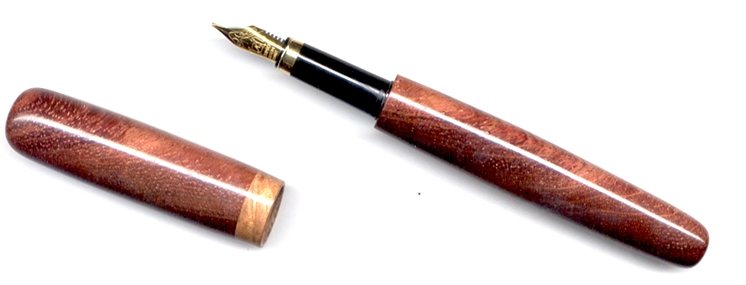

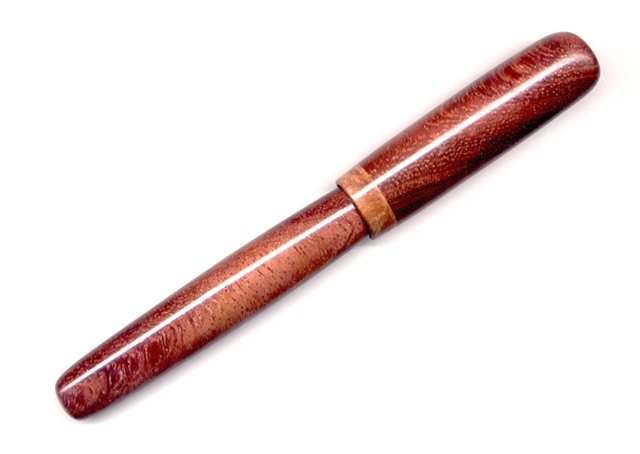

A while ago during the Schmidt pen refill group buy someone mentioned the Schmidt catalog had fountain pen kits. It end up that they manufacture parts that they then sell to pen companies to use. I know that Acme pens use these parts and Reto 51 had used them at one time. I managed to convince a sales rep to send me a couple samples to see if I could organize a group buy. Well I doubt a group buy would work out but this is one of the pens I made from the parts he sent me.
It is cross cut Bubinga with a Maple Burl accent band. Comments and critiques are welcome.
Mike I hate to say this but the ends just don't do it for me. I think that maybe if you flared the ends up with a flat end it may be better. I like the all wood and both ends closed but the rounded effect...I just don't know how to describe it other than to say that it look to home-made. I like the shape of the bottom but the top, maybe if you tapered the top like you did the bottom.

I'll leave the overall comments to others, but I have a concern over one of the design features. At the nib holder, there appears to be a significant shoulder between the level of the wood and the housing...looks like it might be as much as 1/16". In the work I've done I find that any shoulder more than a couple of thousandths is uncomfortable. How do you find the feel when you are writing with this?
Very elegant Mike. The lines are very simple and clean which really lets the wood stand on its own. The woods work well together and its nice to see them uncomplicated by shapes and hardware. Another thing about this pen that works is that it won't date itself. If you saw it in a b&w photo sitting on a lap writing desk it would look at home just as it would sitting on a stainless steel desk next to an ipod.
Along the lines of what Lou said, I am a little concerned that after posting the cap many times you might see some wear at the shoulder.

Lou - for the fountain pens kits they want a 500 minimum order, which is one of the reasons I do not think a group buy would work. The shoulder is actually slightly over a 16th. It feals okay to hold in my hand and simulate writing, not great but okay. I will ink it and start useing it when I get to work on Monday.
Anthony - it is 7 mm nib and it looks the same as the Jr, baron, series 2000 nibs. I will try swapping nibs with my Jr, and series 2000 fountain pens at work next week. One of the reasons I was interested in this is they will make gold nibs with a 200 unit minimum purchase.

Mac it is a snap cap. The parts I got from Schmidt were
1. The nib, feed, front assembly
2. The threaded coupler that you screw the front assembly into. ( I had to epoxy this into the tube.)
3. A snap sealing cap (I used epoxy to secure it in the cap.)
if you go to there site you can take a look under fountain pen system
you can get an idea what I am talking about
http://www.schmidt-feintechnik.de/frames_engl.html.
By the way I love the way it writes, I have only used a Jr. Gent and a Series 2000 fountain pen before but I like this better than either of them.

Mike: Someone asked about damaging the finish when posting the cap. Will the cap, infact, post to the pen body or is thge pen meant to be used unposted?? And a second question.....from the picture, the cap is quite a bit bigger than the pen body and there is a noticeable "step" where the cap and the body meet when closed. Is it possible to reduce the diameter of the cap so that the cap to body transition is smoother when the pen is closed??

The pen is to be used unposted.
Their is step though I would not consider it large. I counter a hole in the cap so that the body goes in slightly and you get a nice tight fit. You could reduce the diameter of the cap but you would have to abandon the counter sunk hole. I have made 2 pens like that before and it can be a pain to get the top and bottom to match up.

That nib looks real close to a Baron or Jr nib, is it?
Anthony I know I am late on this but I just got around to trying it. The nib does not fit in the Jr it is to loose. However as a side note I was having problem with leaking (nib to wet) in this pen and put my jr Gent nib in their feed mechanism and it works great. Apparently the extra thickness made for a better fit. Possibly the test nib I got had a manufactureing error but I suspect the thickness is slightly different.
