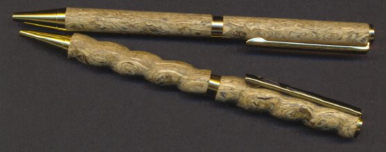

I've had more success with scanning than photos. I bought an HPscanjet 2400 at Office Depot for $59. It's easy to edit, no dust, very sharp quality. I scan at 300dpi. The only tough part is sizing for this site requirements. I put the pen on the scanner bed and in this case put a piece of black rigid fome-core on top of the pens. I used the fome-core because I had some and like the sheen. Here's the result.

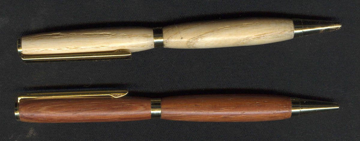

The notion of scanning pens struck me as something unique. Normally (thinking inside the box) I had never even considered trying deminsonial objects on my scanner. But just for the 'h' of it, after reading some of these old posts, I tried. Being lazy I went no further than my black mouse pad for a backing. The image below is of two non-descript slimlines of contrasting color for the test. I am amazed at the depth of field and detail. I was able to enlarge the image (scnned at 300 dpi) seven times before it broke up. And for those of you who look closely at such things: The light colored pen is ash. Doubtfull I will ever try ash again for small turnings as the grain is so open and impossible (for me) to get really smooth. Glad I didn't wast a Euro or Gent on this wood.

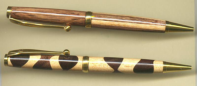

I just lay mine on the bed and put a little paper box over it and scan. I use 600 DPI with the 16 million color setting.
Then I usually brighten it a little bit and run the Un-sharp mask to clarify it (I am using Paint Shop Pro 8.0)
That is how I scanned these pens
