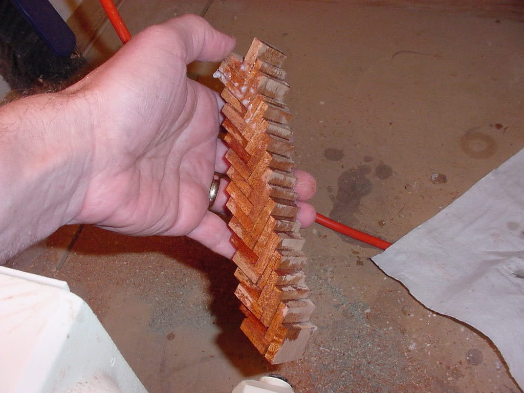

Here's how I do an easy herringbone style:
A series of 1/4" thick 2"X2" slices glued together (this is mahogony)...
Turns to make nice scallops and beautiful edge grain (this is Eucalyptus)...
Vince. I am trying to glue up the herringbone blank you have pictured. Are you sure the pieces are 2"X2" ?? The one I am making looks a lot larger than the one you have pictured. Just checking but it looks like a lot of waste with a blank that size. Thanks,Tim.
I'm not exactly sure what size those slices were cut ( I made that about 6 mo. ago) but your glued up piece should be at least 2" square when finished. Once you cut it down to the final blank size you should have enough material left to turn any diameter pen kit available and will leave enough edge distance to get past any occlusions in the wood.

I saw that turorial but I didn't go clear to the bottom pages to notice the herringbone info. I still think the blank I made is too big using 2"X2" pieces. I just finished the glue-up and am waiting for it to dry. After I trim it up to make it square I am pretty sure I can cut it in half to make two herringbone blanks of about 3/4" square. That makes me think that if I used it to make only one pen blank I would be wasting material. When I get to the point of cutting it up to make it square and I end up with two blanks I will post a pic. I am not sure when I am going to make the pen/s out of it as I have other projects right now.

I was incorrect when I said I would probably get two blanks out of the herringbone pen blank because of the 2"X2"X1/4" squares.
I thought they looked pretty big as I was making it.
But instead of one herringbone pen blank I got two. Plus 4 more angled segmented blanks. So I got a total of 6 pen blanks, 4 3/4" X 3/4". :eek:
Thank you again, Vince.
Tim.

I'm sorry Tim and Don, I should have been a bit more clear on my blank size target.:redface:
1.51-1.5 to 2x2 is typically the size of the untrimmed blank (the slices are about 1.5" square) and after you finish sizing it on the table or band saw, my end result will end up being about 1" square. I'm a bit sloppy on my glue-ups and I'll trim off a lot of stock to get down to a nice solid smooth surface.

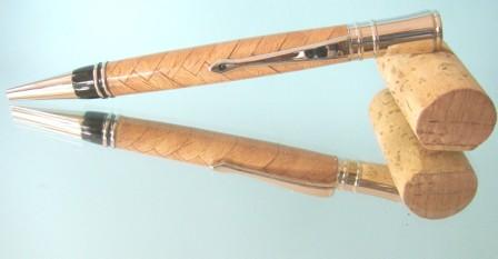

Herringbone in maple
Thanks Vince,
I tried your method and glued-up with epoxy but it blew up when turning. The second I did with CA and turning was slow because my skew required sharpening every 3 or 4 passes. Plenty of thin CA used to keep it from blowing up. I am not happy with the end result as the finish appears to be 'bumpy' if my expression is descripitive of it. More sanding has made the blank too thin for my liking and finishing with CA has not helped. Perhaps I should add a few more coats of thick CA to get a better smooth finish.
Please see a picture of the pen . Any advice will be appreciated. I hope I am not going away from the original post. Sorry if I have.

Not that you asked me, but I used a 1/4" bowl gouge. Going with the direction of the pattern helped prevent tearout at the seams. Finished off with a sharp skew. Only problem I encountered was the different densities of the different woods (I alternated maple and walnut side to side) made the skew want to dig in deeper on the maple and skate over the walnut, so light passes helped, and I sanded to final dimension.
Stephen, it is possible to build this blank using wood glue. When I built a herringbone blank I used Titebond original. It is easier to work with than CA, more time to align the pieces, and it dries clear without any shadow line. You do not have to use clamps. You can assemble the blank one piece at a time using a "rub joint". Put glue on a piece and rub it against the piece you are joining it to. As you rub you will start to feel resistance as the glue bonds. Align that piece and start on the next. I think you might also find turning the blank easier, there will be less resistance as you cut across the glue joints of the blank.
