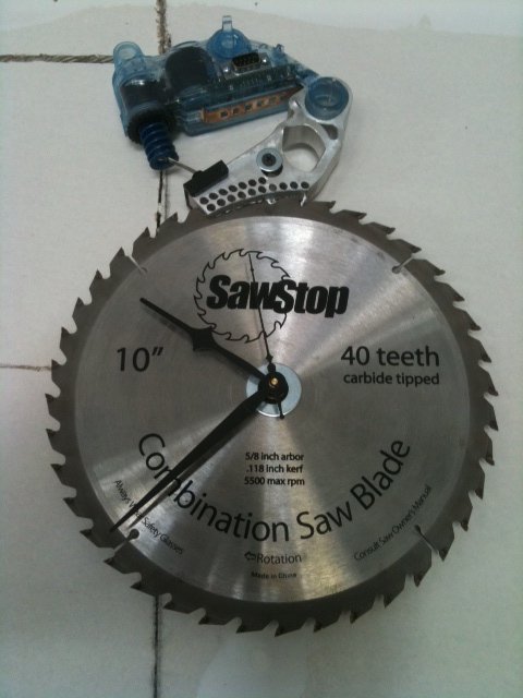

Back to the topic at hand, I have had a 3HP PCS with 52" rails for almost 3 years now. I love the saw. I have used a Powermatic 2000 and 66 as well has the new Delta Unisaw. I still love my SS obove them all. Although, just because the metal detector says no metal, the lead musket ball will still trigger the break. That is how I got my fancy clock!
