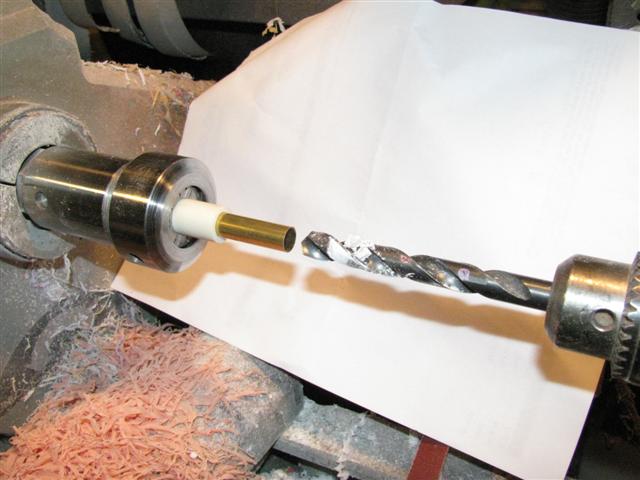

Last order, I bought some 15mm Alternative ivory rods. VERY close to 5/8". Now, I have put them in my Beall collet and drilled the 10.5mm hole that a sierra uses, and BINGO!!! a nearly finished pen!!!
This pic shows the 15mm blank (with the sierra tube partially inserted) and the drill bit - 10.5mm. As you can see, it leaves enough material to finish off the pen, even if you choose to make a "Vista" version.
Those who have the Pen Wizard, this is a GREAT starting point for making blanks for the Wiz. Mount them on the Wiz and put in your pattern, fill with epoxy and desired color and re-turn to finished dimension. Also sand and polish as usual.
Save time, money and waste!!! I like that!!!

Dean,
I think that would be pushing the envelope (tho you are NOT the first to inquire). My suggestion was to do the pen section with 15mm and the cap with 20mm - there is no "grain match" on alternative ivory, so this would work. On the other products, I wouldn't try it, personally. (But, then, I broke an "Eagle" blank some time ago in a process like this, so I am pretty gunshy!!)
Don't have a pen wizard, but I'm curious Ed - Will this work for the Jr Gent too (with the 12.5mm?? Or is that too tight a fit?
I'm not certain about 15mm, but I've used 16mm cumberland to make Jr Gents and there was plenty of material available for shaping. Not a ton, but enough to justify the use of a skew to slice some off.
Thanks Kurt!!
It is probably POSSIBLE, but drilling has never been my forte'. It would require a sharp bit and a steady feed (NEITHER of which fit my pattern!)
I don't doubt for a minute it COULD be done, but sure as I recommend it, I will hear from half a dozen people who tried and blew out the blank - they will recall I said it COULD be done - that's all they will recall. Safer to say it's difficult and marginally possible!!!!
I hear ya, Ed. I've said many things are *possible* based on my own experimentation, but then heard from people who claim the exact opposite - usually when it ends up costing them money.
