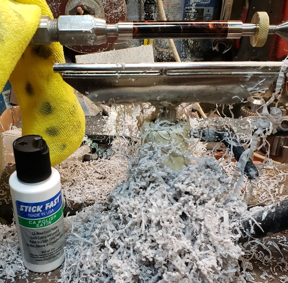

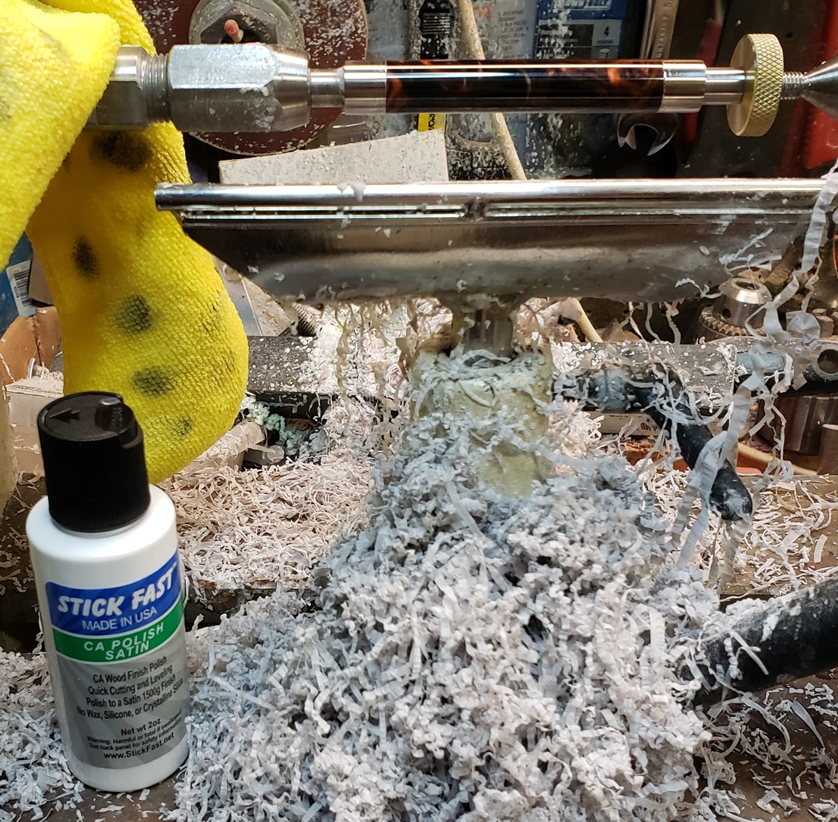

I see Stickfast makes a satin CA polish, does this work if anyone has tried it?? What is your thoughts for finish and feel. Thanks.

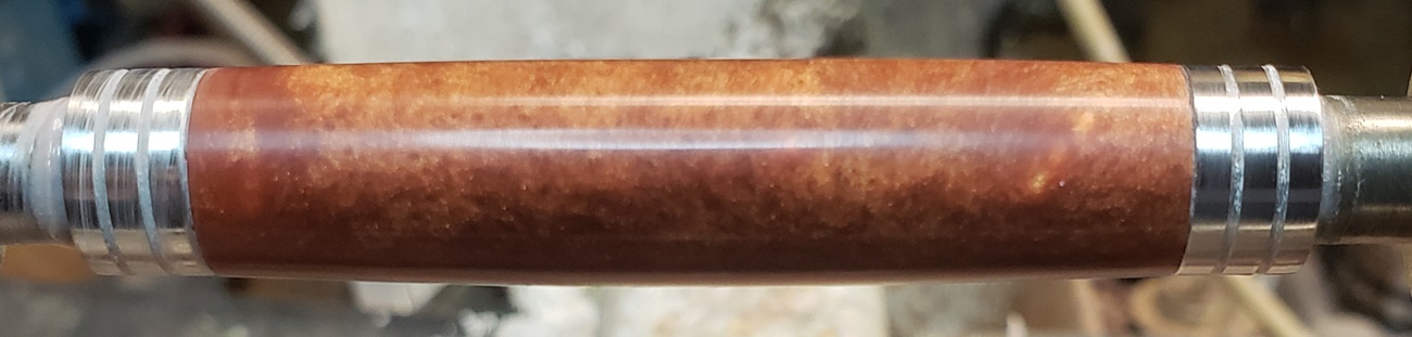

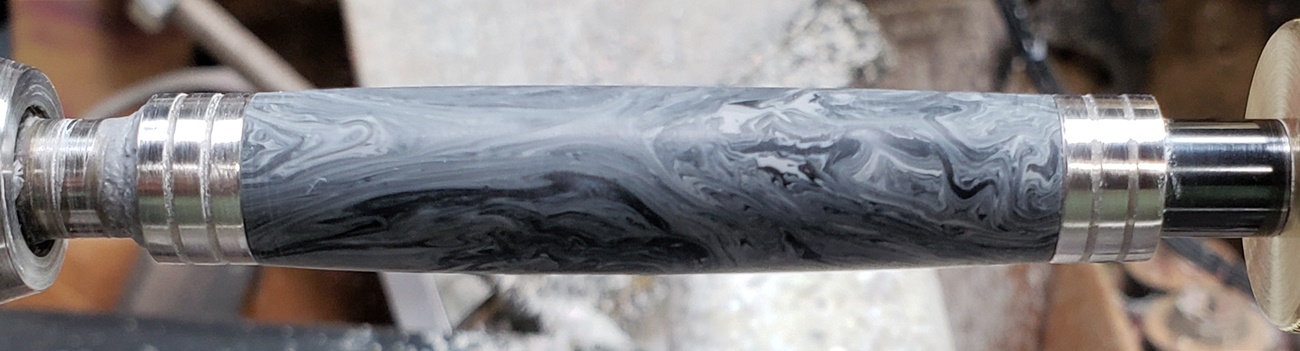

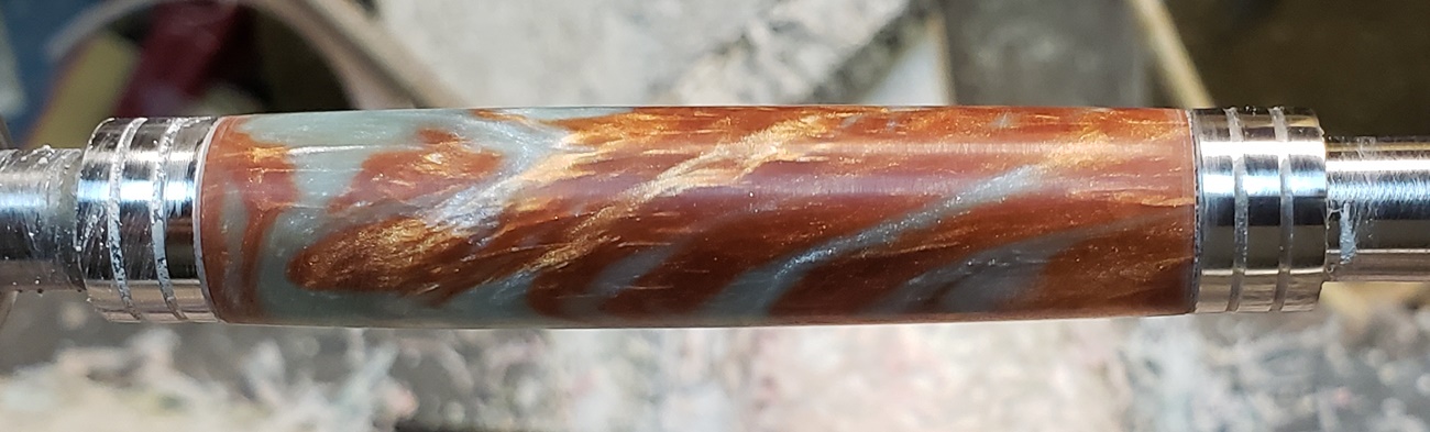

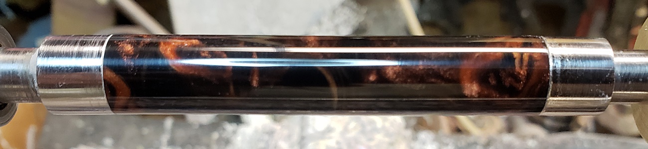

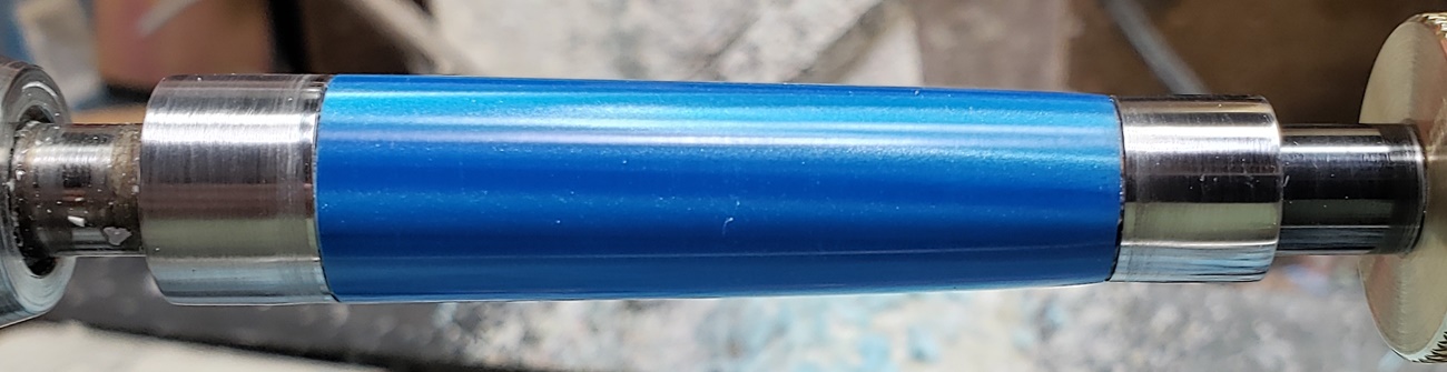

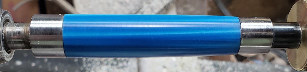

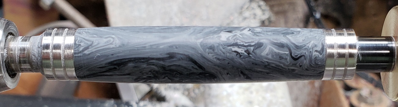

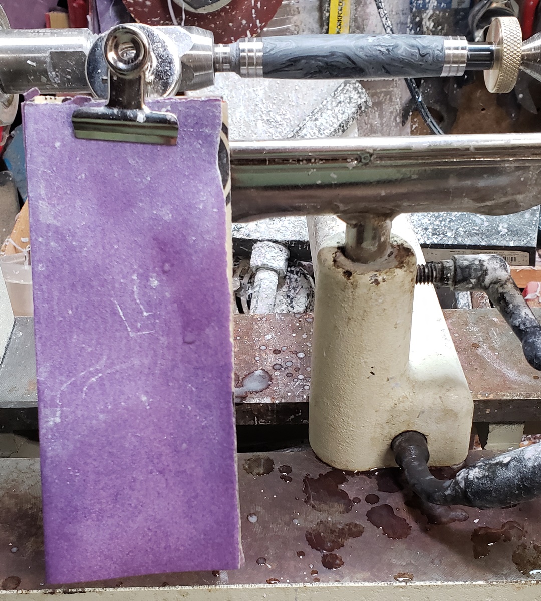

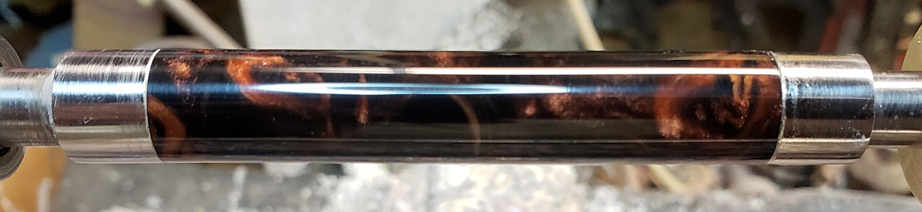

I tried the Stick Fast satin polish, but it wasn't very satin. This was after 3M Tri-M-Ite.

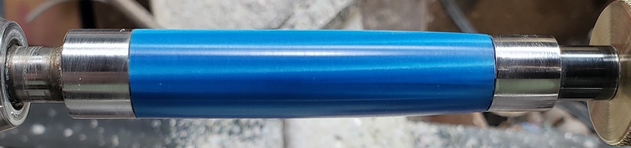

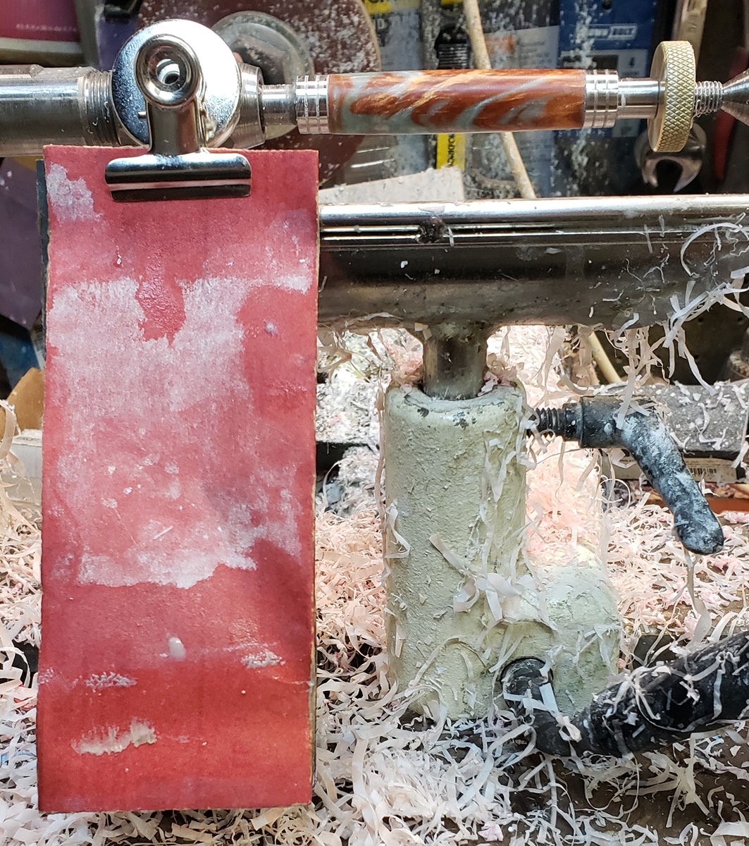

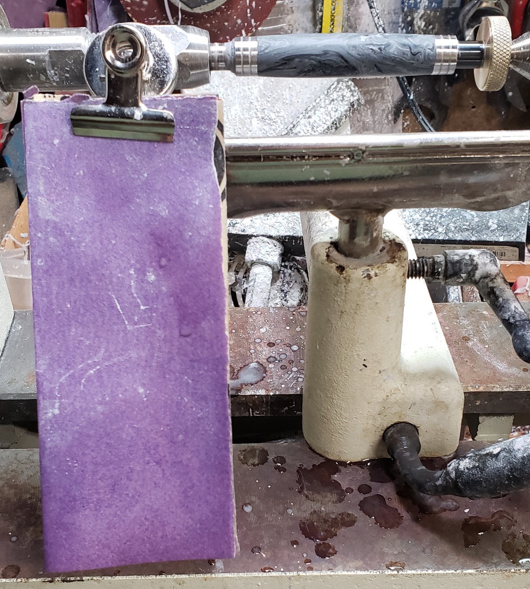

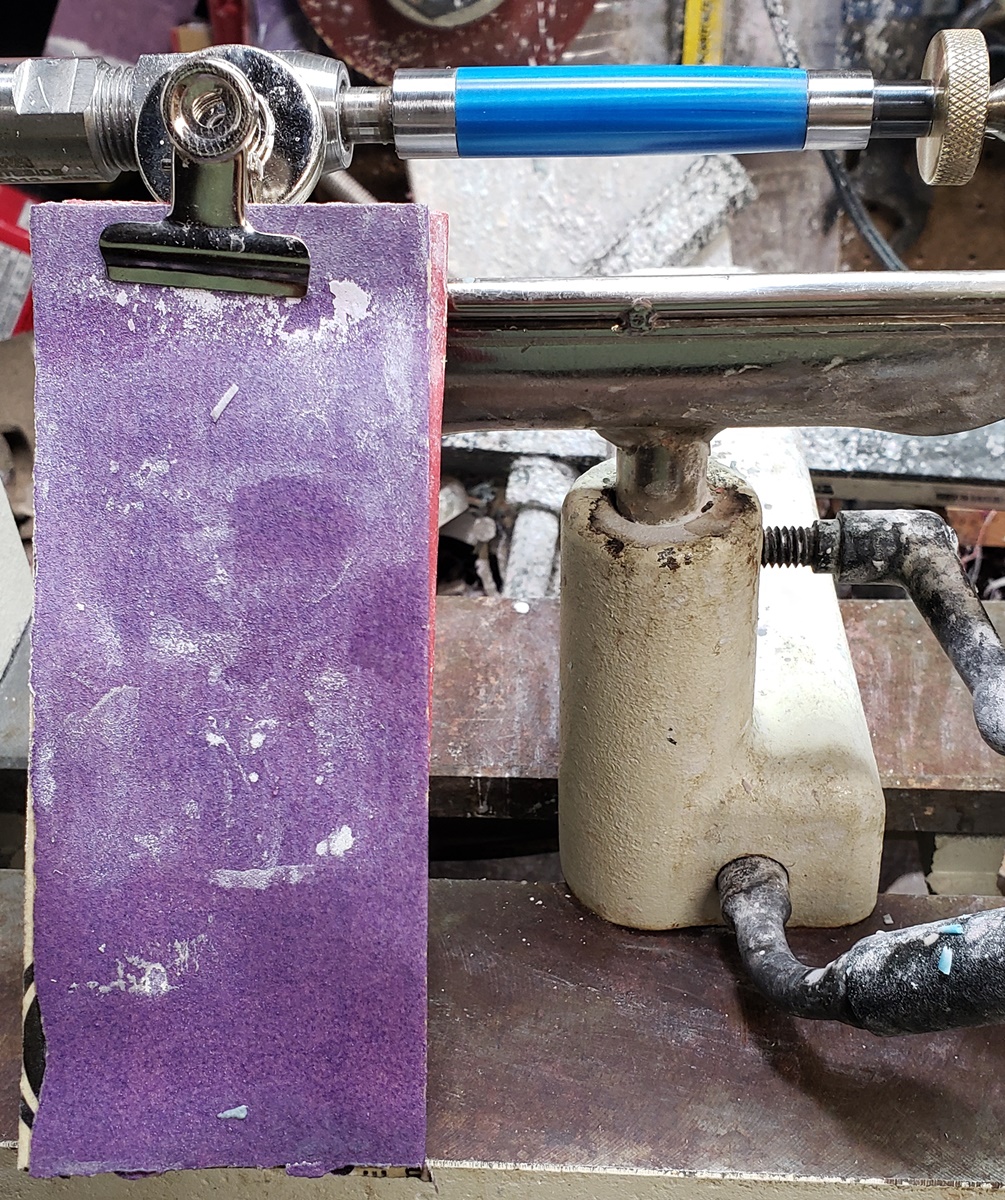

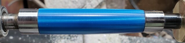

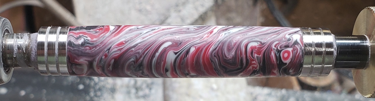

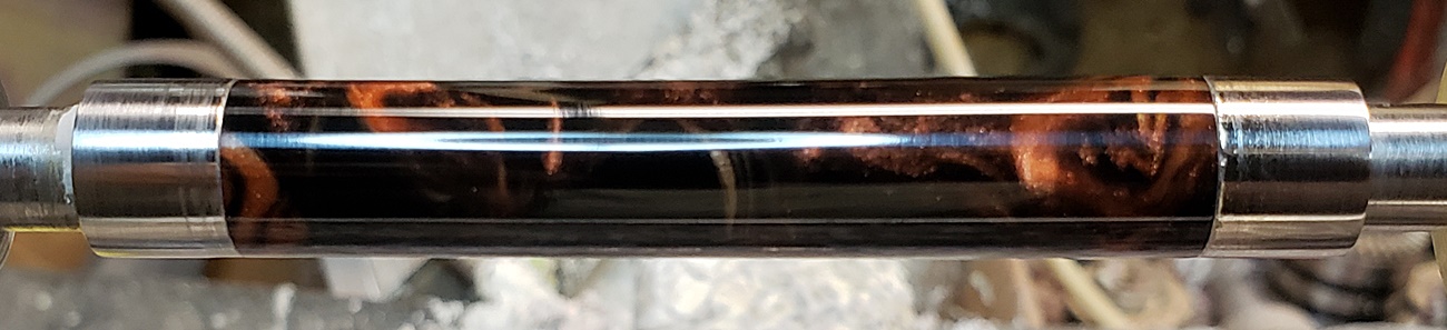

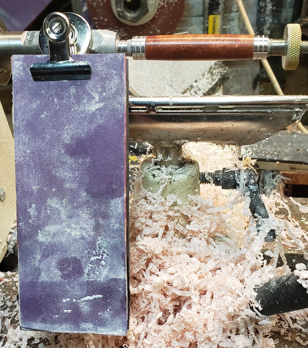

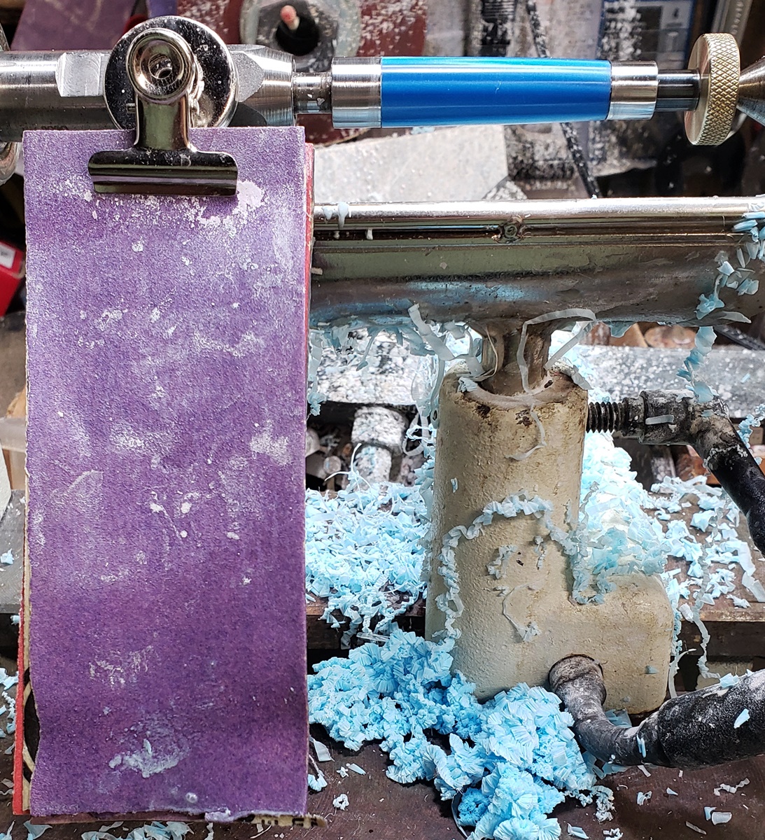

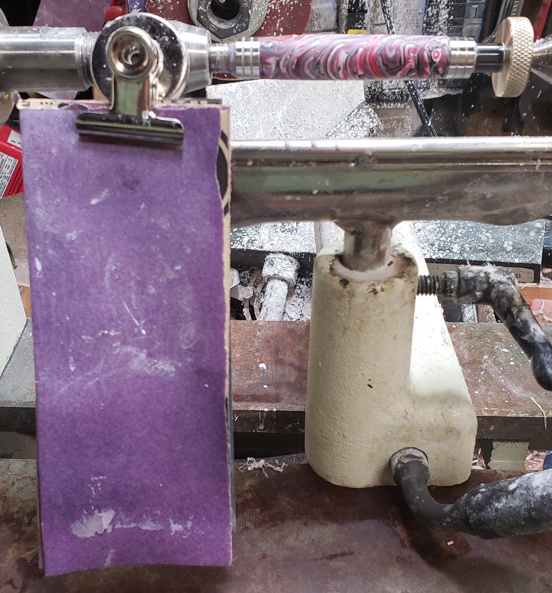

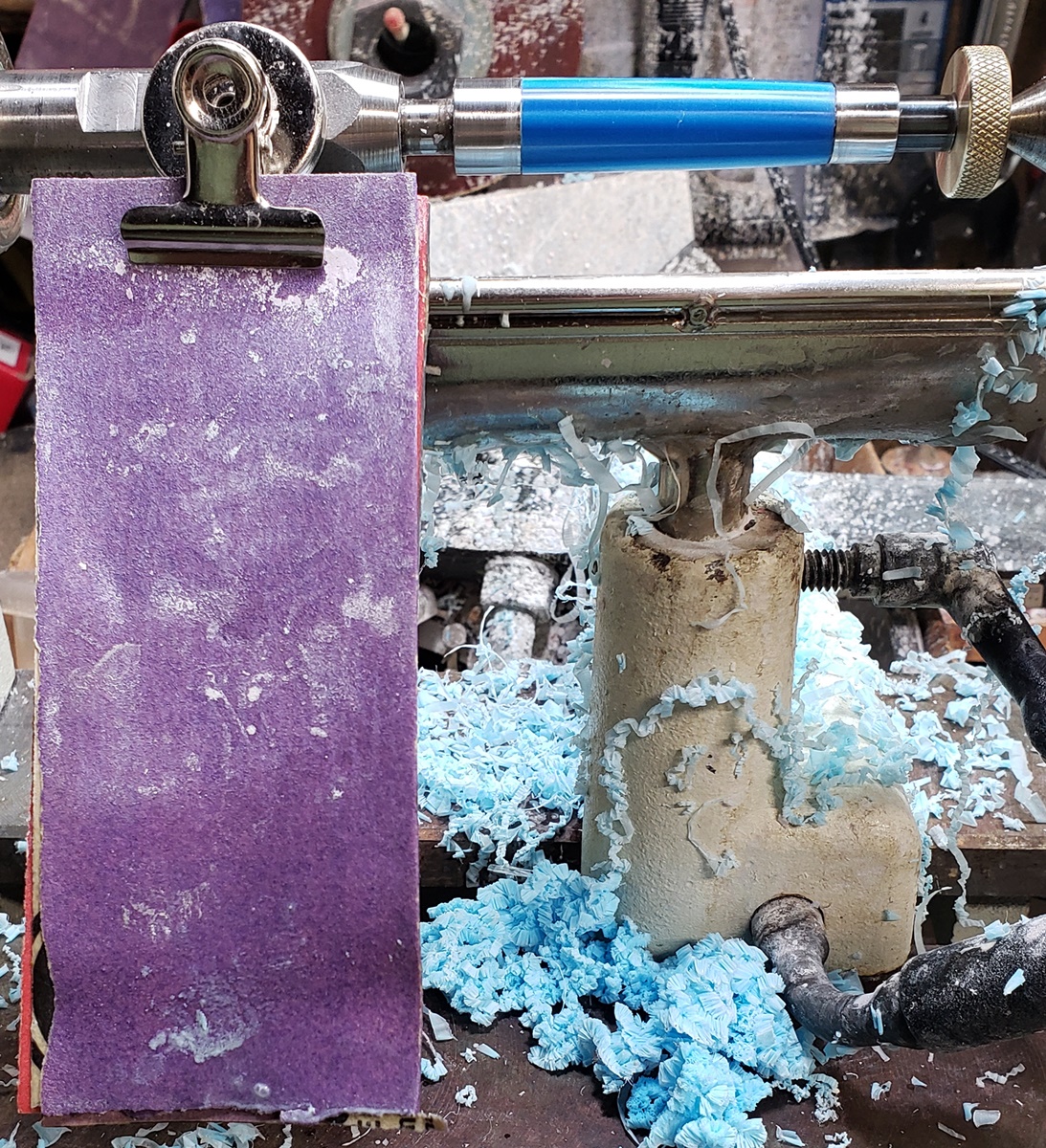

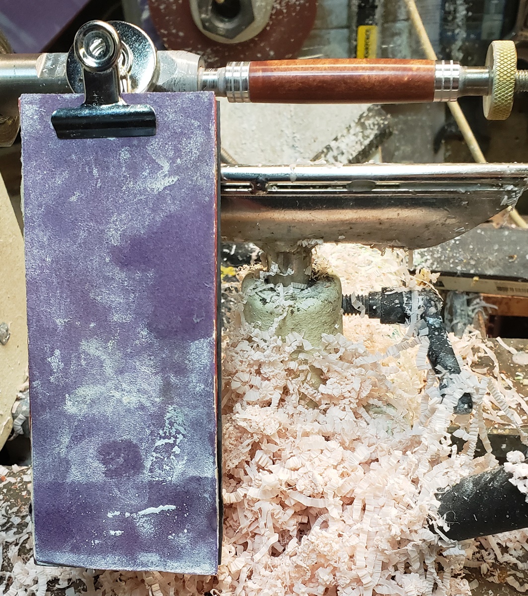

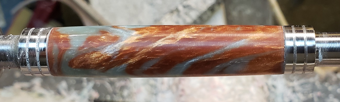

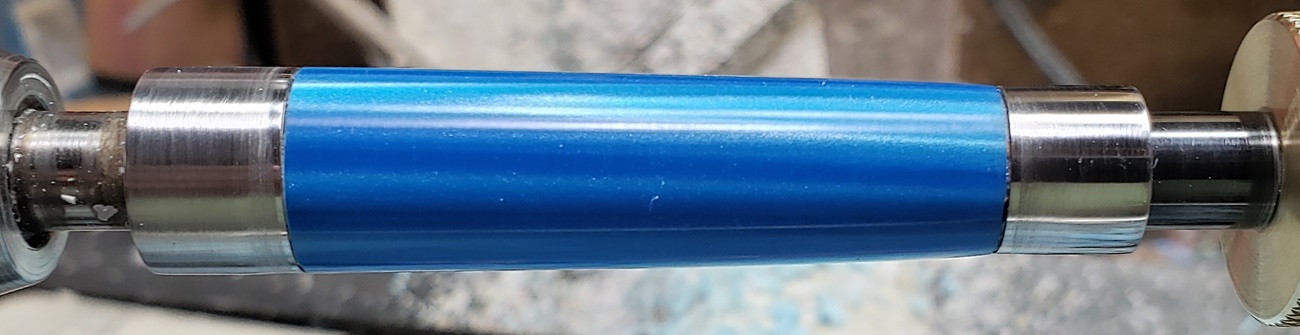

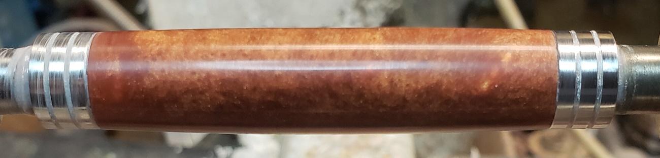

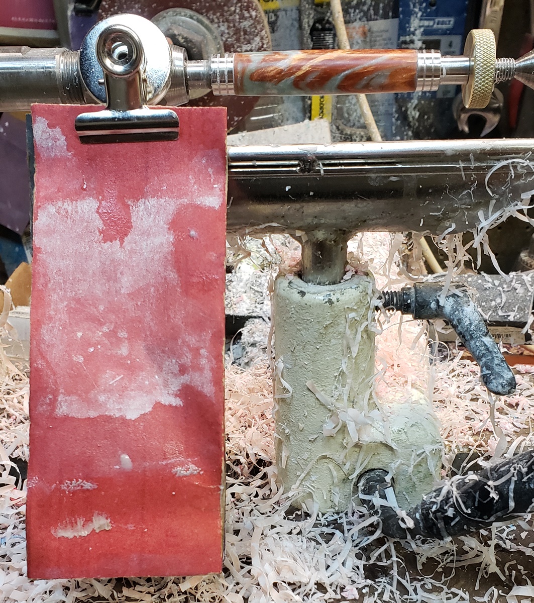

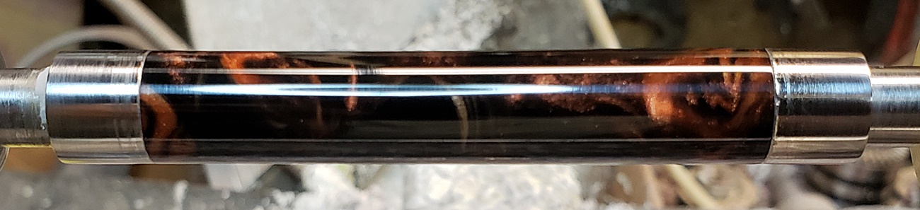

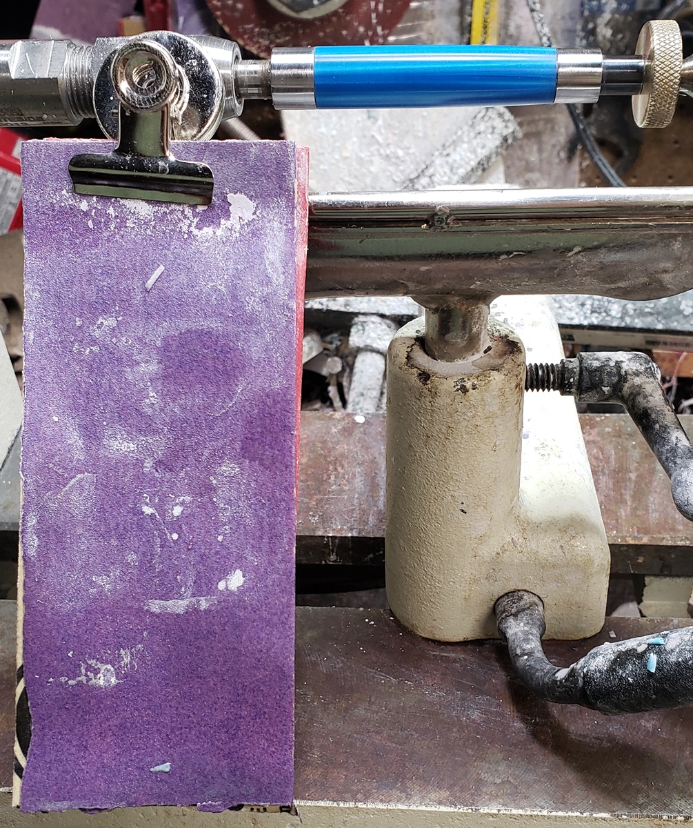

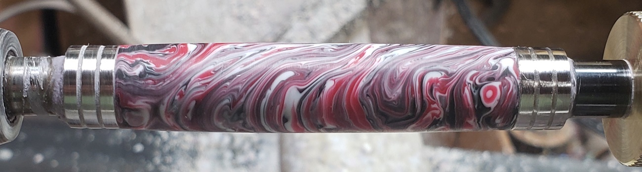

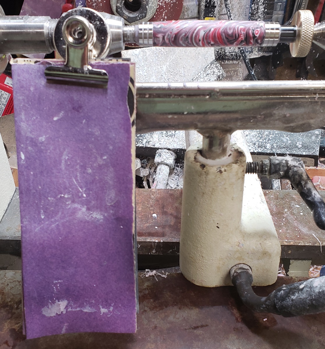

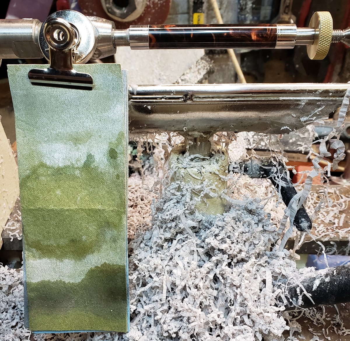

I have a friend who prefers satin finish pens. The best results I've gotten are wet sanding through 600 grit. Sometimes it leaves visible scratches, I don't know why. Type of acrylic, maybe?

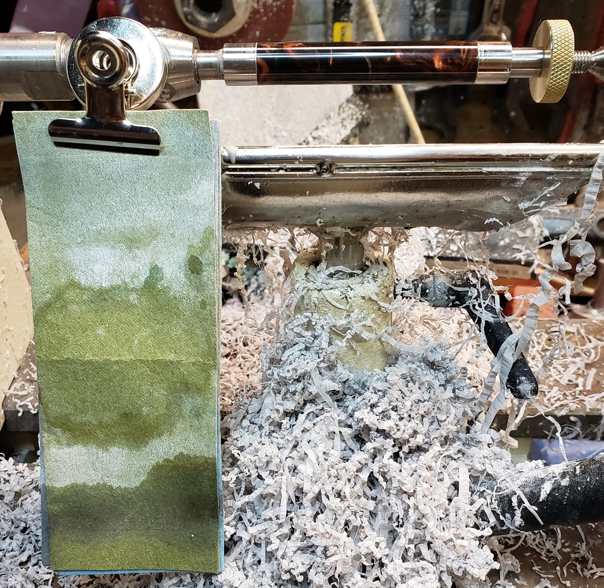

For acrylic satin, I'd use micro mesh and just stop half way through rather than working through all the grits. For wood, have you considered no finish at all, sanding up through 800 grit, then micro mesh. Buff it out with a couple coats of wax. That leaves a nice matte/satin finish on the wood. Works best with woods that are very oily. Here's one I did in gaboon ebony:

When I want something to come out matte, I just stop at a lower grit. There's always an intermediate where the scratches are too fine for the naked eye to see but not so fine that you get a high gloss finish. And if I "oversand" and get shinier than I want, I just move back one grit and sand as lightly as I can to scuff up the better finish.
I know this works with acrylics because whenever I try a new material, I stop and look at the shine throughout the process. With every material I've used so far, it goes from "eh" to "ok" to "now we're gettin' somewhere" to "wow" to "daaaannng." If I were going for a matte, I'd just stop in the neighborhood of "now we're gettin' somewhere."
