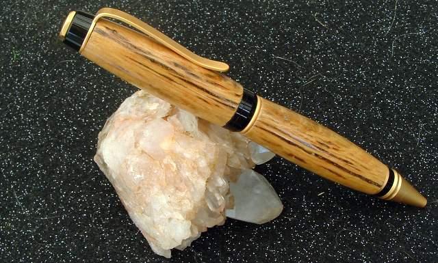

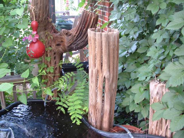

We have had these saquaro skeletons for at least 25 years and I told my wife that one fell over and broke He!!He!!He!! So she said why not try a pen, what do you all think ( Hope she dosen't find where I sawed it off [}:)][}:)][}:)]
Beautiful pen. did you use black resin or clear? Did you use a pressure pot or anything like that? Thanks, Alice
Alice I just used thick CA. I noticed on the photo that the bottom barrel looks proud so I went to the pen to check and its not don't know why in the picture it looks proud. I use calibers on all my pens. Getting back to your question I just filled all the openings with thick CA and gave it a Ca finish and sanded it after each app. of Ca with MM all grits
