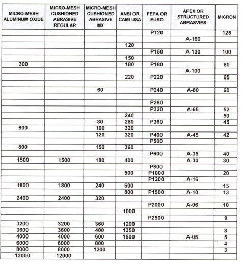

Sandpaper equivelant to MM?

Beats me, but the highest grit MM (I think) equates to about 6000 grit.
If you dont have any MM yet, make your life a lot easier and get some. Definatly worth it and lasts much longer than sandpaper.
Here ya go

I've got some but I think I'm wearing it out too fast. The absolute best finishes I have done have been with brand new MM. I clean it almost after every use now. I was thinking of using regular sandpaper up to 2500 and then finishing with the last few MM grits. The way I cut a 9 x 11 sheet of sandpaper I can get 32 pieces of the size I like. Ultimately if you used new sandpaper on every pen it would not be that expensive and in theory should be more consistant.
