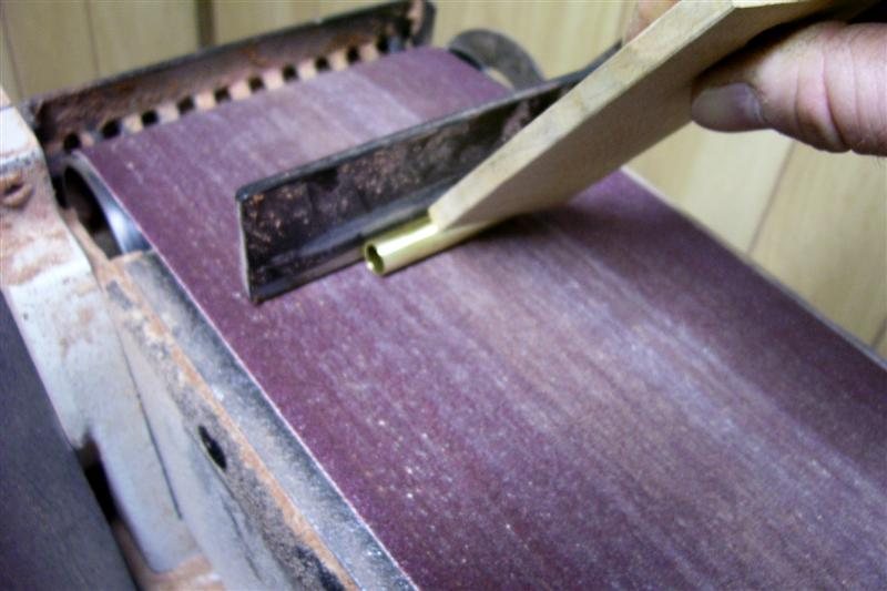

How do you sand the tubes?
What grit?
I just started doing this, and so far it seems to work great... certainly is a lot faster and the tubes really come out shiny with lots of scratches for the CA to cling to...
It's an old circuit tester... and it fits the 7mm tubes perfectly...
Anyhoo, wanted to share and see what y'all do...
