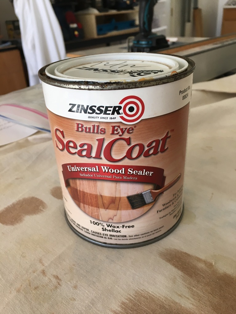

I apologize twice that this might be old news or in the wrong section, but sanding sealer is my new best friend.

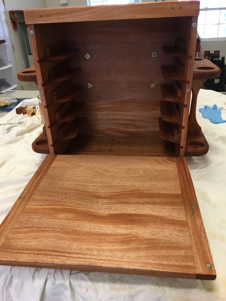

I bought this can to seal a vintage bass guitar and fill the grain. The luthier asked me to sand down the body and apply sealer until the body was smooth and well sealed. The can stayed idle until I moved and I used it as a first coat on some small projects. The results were great and I cut my number of coats in half and still achieved the same results. I tried a Mylands product on wood pens once and got tons of white dust in the grain. It could not be removed or sanded out so I stopped using it. This stuff is far cheaper, works and leaves dust that blows off easily. I just coated this huge project with it. The grain popped immediately.

Technically, you are not using sanding sealer. You are using a wood sealer. Sanding sealer is usually lacquer with zinc stearate added for the easy sanding. It is usually softer than lacquer because of the additives.
Proof in the finish pudding. The wood sealer and five thin coats of wipe on spar varnish made it glossy and smooth.
