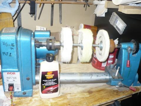

I use Meguiar's Mirror Glaze; Show car glaze, #7 when I buff. Puts a glass like finish on the CA.
