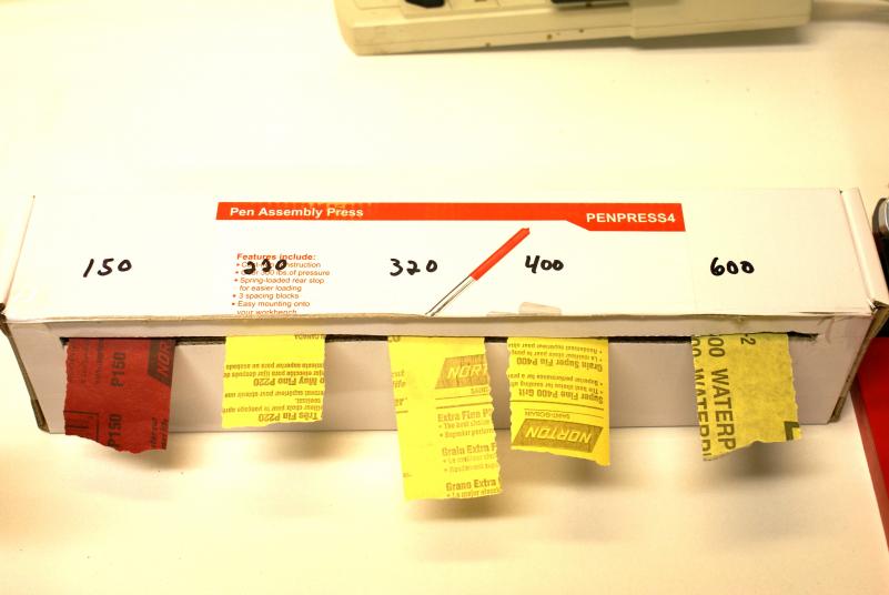

I cut my sand paper up in strips , taped the strips together while rolling them up. I then used the small pen press box to dispense them from. Works great!
