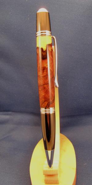

Ron if you use a skew like a scraper you can forgo the rougher sandpaper. I do this and start at 220 or even 320 and then wipe it down with DNA. If I see no scratches I then do my CA Finish and do nothing but wetsand with 400 to smooth out the finish and then look for the ripples and after that I wetsand through all but the first 2 MM pads which I keep soaking all the time. Here is a pic of the one I did last night not a great pic but it shows up nice.
