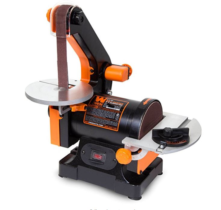

I got the $100 WEN combo off of Amazon. I don't use the belt very much. Actually I don't use the disk very much anymore either, I square blanks on the lathe using a collet chuck and skew. If I went back in time, I would probably get the 12" Harbor Freight disk only sander, which is only a little bit more money. The 6" disk on the combo is pretty limiting, and the cheap belt isn't so great.

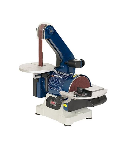

I don't think you need to go to a stand alone to square blanks or round them. I have a 1" belt/disc sander made by Wen that works great for either. I like the 1" belt sander because I added a speed control and use grinding belts to sharpen all of my chisels. You can get a razor edge much more quickly and don't have as much risk with overheating the steel. The Wen sander on Amazon for $70 is actually made by Rikon and is identical except for the paint colors.
