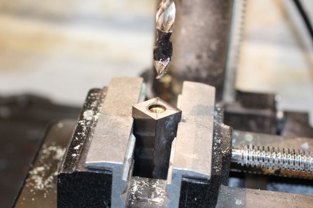

I'm making a closed end Tycoon. I'm working on the cap. The instructions are as follows...
CAP BLANK:
• Mark the center on both ends of the blank.
• Drill a 10mm hole at one end, 11/32" deep (Diagram B & C)
• Squeeze glue drops into the hole, slide the cap insert recessed
end in first into the hole. Let dry.
• Use a sander to square the end over the insert.
So here you see, I've drilled the hole and glued in the insert. I'm ready to use a sander to square the end.
Normally I use a barrel trimmer. Obviously that won't work, as the hole is only 11/32" deep. And the blank is not truly square, and it's not known which surfaces, if any, are truly parallel to the hole.
So how do I sand the blank perpendicular to the hole?
Mike...

I think the point is, how do you hold the short piece in such a way that you know you are sanding the open-ended surface flat and accurately perpendicular to the axis of the very short hole inside the threaded insert (tube).
It seems to me that a short tenon, loosely fitting inside that tube will not do the required job of maintaining perpedicularity.
You have to somehow find a surface which is parallel to the insert tube axis and devise a way to work to that.
Maybe I am missing something that is fairly obvious.
Aha !!!!!
Edit: . You could leave the cap blank in the vice exactly as it is in the last picture. . You then would mount the mandrel suggested by Jolly Red in place of the drill bit ... but I think such a mandrel used in this way does not need to have a short tenon going into the threaded hole; it just needs a flat surface accurately perpendicular to its axis with sandpaper glued to the flat surface. In fact, instead of making such a mandrel, you could use a barrel trimmer with the cutting head reversed and glue sandpaper to the flat end (barrel trimmer shaft tightly in the chuck of the drill press).
