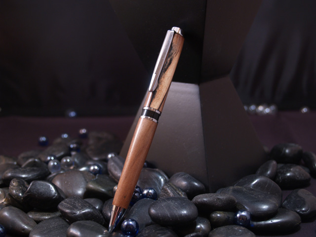

Salvage Woods
woodtreker
Jul 15, 2008
69
Minorsville, Kentucky, USA.
I love making things from salvaged woods... Here is a pen from my neighbor's apple tree that had died and been cut down... I make several pens from this tree and a small jewelry box... Since the tree was so dead it was hard to find good wood... But it gave me some interesting figure...

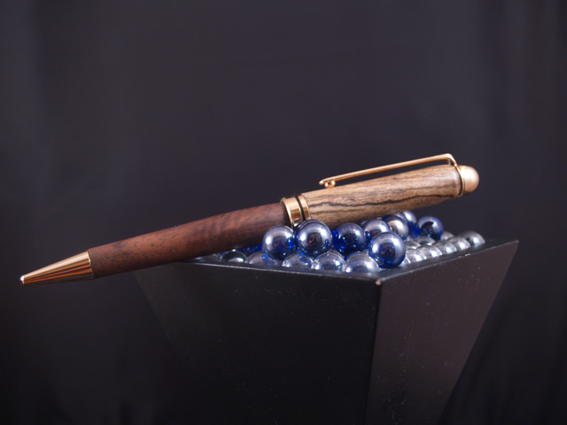

Salvaged Woods
Here is another salvaged wood pen turned from hackberry and walnut... direct from my firewood pile... I discovered the spalted hackberry and also the beautiful figure in the walnut when playing around with a jig I made for cutting log into blanks... They never made it to the fireplace...

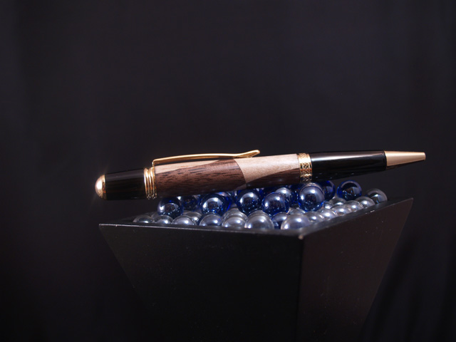

Salvaged Woods
Here is a segmented pen made from walnut and maple... Both of these are from cut offs from a sawmill that were due to be made into charcoal... Lovely pen... I have used these blanks for several pen styles but this is the Wall Street II...

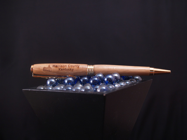

Salvaged Wood
Here is the last for now of the salvaged wood series... This pen is from an old oak tobacco stick that was used for housing tobbacco here in Harrison County Kentucky... It even smelled like tobacco when it was turned... I made several of these for the local County Judge Executive for Christmas gifts...
How did you get the engraving on it? Did you take it some place or do you have a tool to do that? I'm new to turning but I have a lot of requests from friends and family to make pens that have their names on them.

jig for cutting logs into blanks
Hey woodtreker, what kind of jig are you using. I'm trying to cut up some wild cherry logs that have been down for a couple of years.
Richard
I had it laser engraved at a local compnay that does trophies... I created teh art word from a line drawing of the courthouse and the lettering... It cost me about $8.00 per pen since I did several pens... There are folks on this website that do the laser engraving at a great price... Time was of the essence for me so I used a local business...
I have three different jigs that I use...
1. Bandsaw resawing jig for logs to lumber... I found it on the Internet and made modifications for my taste...
2. Table Saw jig that looks like a small panel sled but I have a vertical side that is 3/4 inch from the blade for cutting out the blank to right width... I have hold downs for the blank but not required... (have the same thing for the band saw but like the table saw better...)
3. Table saw jig that also look like a small panel sled that I use to cut the blanks to the correct length... I have a hold down for the blank...
I will take some pictures and post...
