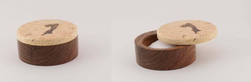

Kiaat and Box Elder Burl Salt Vault. Shown closed and open with kosher salt inside. Lid is hinged. Finished outside with EM6000 waterborne lacquer. The offset bowl for the salt has some freshly made shellac to seal the wood. Went with shellac for the inside since shellac is an FDA approved food additive.

Hey, I was looking for hinges that could be used to make these salt boxes a couple of months ago. Would you share where you found them? I thought about just using a brass pin, but I know they make actual "hinges" for these things.

Chris, I just use a 1/4" dowel. I considered metal hinges but decided against it for potential corrosion issues. I may be worried for nothing, but the combination of metal and salt seemed like a bad idea unless I was going to use something like 316 stainless steel. For the same reason I chose not to include a small magnet in the lid and a steel pin opposite the hinge as a sort of magnetic latch.
cool on the salt vault. i've been wanting to make one for a while. did you actually turn the top or just cut a circle and fit it to the salt holding part? that bowl looks nice too!

The lid was roughed round on a bandsaw then the hinge pin installed and the lid then attached with double sided tape. I could then turn the lid and body as one piece to perfectly match the lid to the body.
