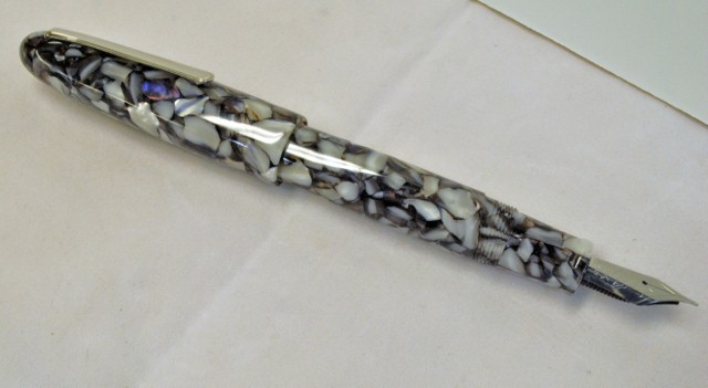

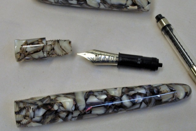

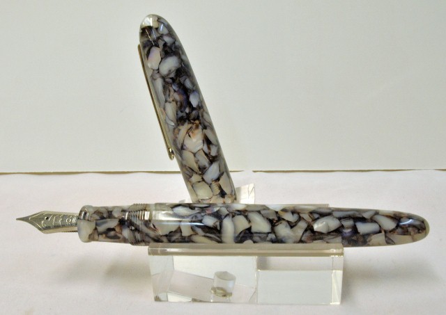

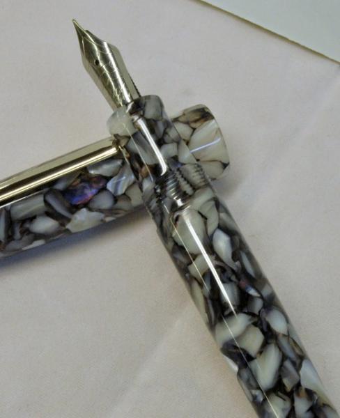

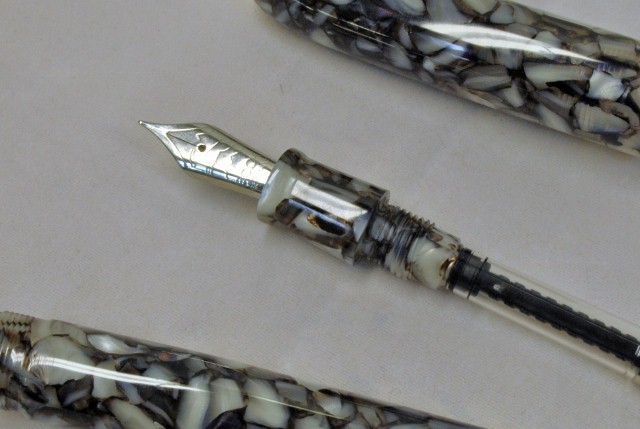

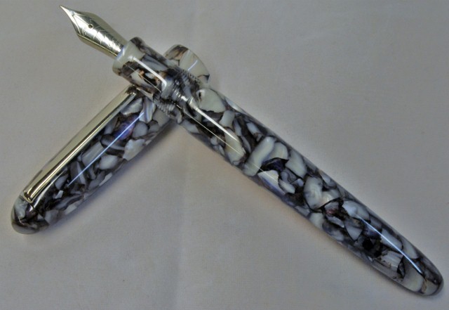

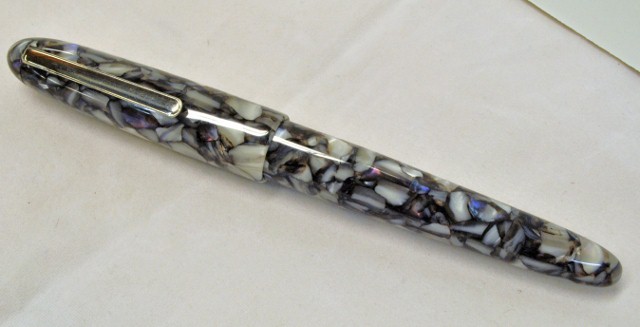

This was a prototype for a pen I did in Cumberland for a customer. He wanted a pen that matched the dimensions of the Sailor King of Pens. I chose cracked ice acrylic for this prototype.
The dimensions:
  • Length capped - 6"
  • Length uncapped -5 1/8"
  • Length posted - 6 1/2"
  • Barrel diameter - 9/16"
  • Cap diameter - 5/8"
  • Weight - 27 grams
The most difficult part was the cap/finial/clip joint. On the Sailor, that joint is at a point where the diameter is just 10 mm.
The polished nib is a #6 Bock.
Thread
section/barrel - M10 x 1
barrel/cap M14 x .8
cap/finial 1/4 x 32

Awesome work Robert. I really like the looks of this pen. Looks like the polished Bock nibs are the way to go, just completes the pen.
Keith "mrburls"
Copycat! :tongue:
I love it! I'm really glad you posted this when you did. I'd been so curious what the one I did might look like with that nib as well as with a matching section.
Any chance of seeing a pic of the original pen you've designed this after?

Great pen, mate...!
Is this the same type blank as I seen yesterday, (I think) from someone else here...???
The other one looked more "pearly" but, they both look stunning and I just can't remember if these are some of the Italian blanks that are now available or, something else...???
Cheers
George
Robert, Congratulations, you NAILED that one...beautiful...I have a Sailor Black Ebonite King of Pens and tried to make one that resembles it..but you really nailed it with the finial, clip, contour, proportions etc!! You are a superb pen maker!! Now I've got to try and catch up with you. Regards, Doc:smile:
Thanks to all who commented. Really appreciate your support!
Copycat! :tongue:
Yep, see attached photo at bottom. I chuckled when I saw your cracked ice posting--bet we got them from the same nice people at Exotic Blanks. Thanks, Jonathan!

Thanks, George! Yes, Jonathan's (Brooks803) stunning pen was cracked ice too. I believe it is Italian, as you thought.
Thanks very much, Doc! And if you think YOU have to catch up with ANYONE, you've too many birthdays! :biggrin:

Thanks for the pic Robert. Now that I see the original I can definitely say you nailed it! Had I known you were about to post this I probably would have waited to post mine...yours is so much nicer!
