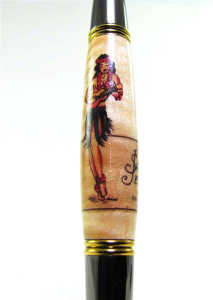

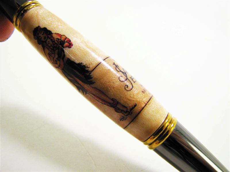

Made a second pen today using my new found decal techniques.This time I used curly maple instead of oak and like the coloring on the decal much better.The hardware kit is a LeRoi in Gold/Gunmetal.

It is a new skill/ techinique for me as I just acquired a color laser printer and the decal paper.
I have not had any difficulty with the decals yet.I apply CA to the pens,about 5 coats.Then I sand with micromesh and then apply the decal.After a few hours/overnight of drying I apply more CA and bury the decal.Polished with Novus 2 and buffed.

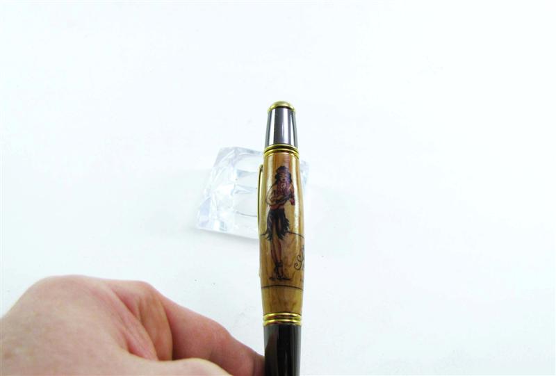

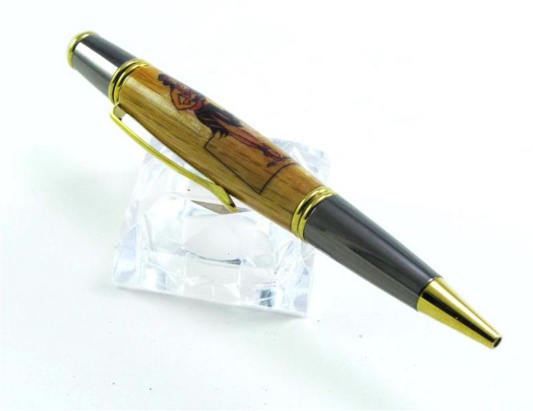

I think some of the boldness/color washing is based on the background wood choice.Here is a poor picture but the same Sailor Jerry label on an Oak blank.
