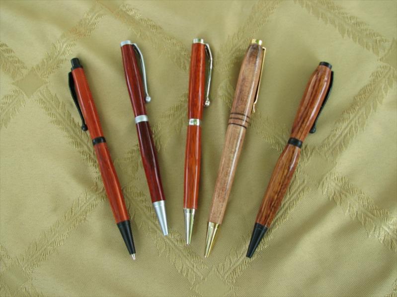

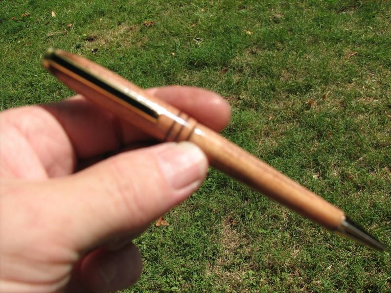

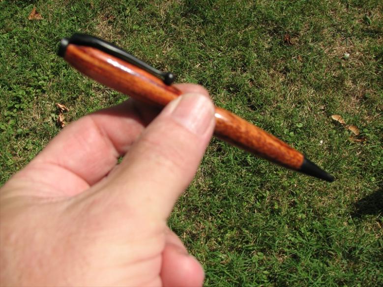

hers goes my first pix
ok here they are
a photographer I am not it seems:smile:
thanks
:redface:
the custom centerband one turned out nice, by forgetting a step i surprised myself.
I wire burned two grooves in, then forgot to keep the grooves cleaned out, sanding step to sanding step. Well the CA bonded the sanding dust into the grooves and it now appears as an inlayed material ! I dont know if you can see it in the photo well, but it is a real nice effect, smooth across. The dust with the wire burning and the CA combined to make it look like a dark brown inlay. I liked it!
