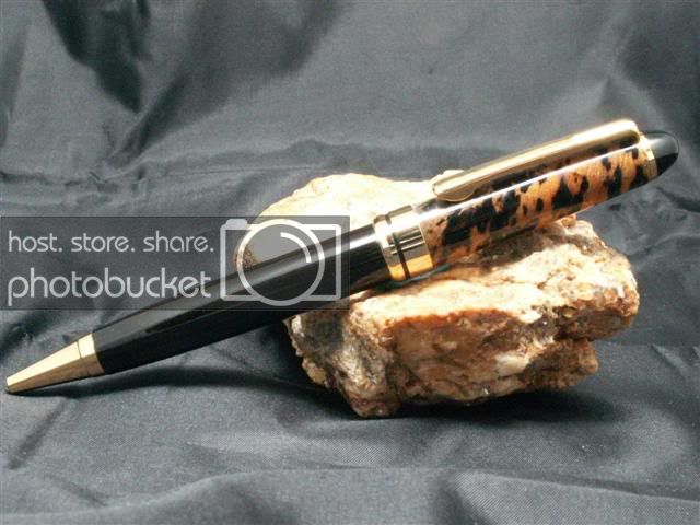

I tried something new tonight. I was applying CA to my pen as I was finishing it. For some reason the CA was not drying very quick. So, I decided to spray some accelerator on a folded up piece of paper towel and rub it on the wet CA. It worked great and it seemed to smooth the CA a little and really made it shine. I did four coats that way. I held the paper towel under the revolving barrels for a little while and then rubbed the wet CA. I think holding it under the barrel caused the CA to set up a little so that the towel doesn't catch or deform the CA. Has anyone else tried this? What do you all think about this? The finish turned out great. I kind of felt like it was like doing a CA/BLO finish, except instead of BLO I was using accelerator. Tell me what you think.
Yes, it will work just as you have discovered. The paper towel itself acts as a mild accelerator. Adding accelerator to the paper towel just makes it work faster, but not as fast as spraying the accelerator directly on the wood.
However, do not let a sample of one make you over-confident. Use too much accelerator or a different accelerator, a different brand of towel, or make one hesitation with the moving paper towel, and you can find yourself with a paper towel that is now as one with the wood.
I've tried your method, and I think that it makes the CA dry too fast.
If you want to slow it down a little try spraying the blank with accelerator, and then wipe it off. Then apply your CA. There will be enough residual accelerator that it will speed up the curing time, but not real fast.
But I still don't like to use any accelerator at all. My best results are just with patience for the longer cure time (which really isn't that long).
Is your shop cold right now? This leads to a slower cure. Or maybe your CA is old.
