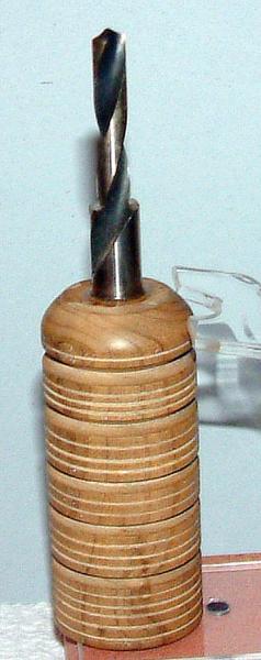

Pic enclosed taken 5 yrs ago of the original penmill I ever bought in the late 80,s cost about 20 of our dollars (not for the faint hearted) then.
This was the only penmill available (made in America) at that time it is what was called at that time a Stepdrill. The smaller diameter is still a snug fit in the Slimline brass, the step is at the end of the 1/4 ish and beautifully reams the brass lightly at an entry angle and cleans any residue in the brass facing the blank at the same time.
Now I predominately make Slims and derivatives and have made huge numbers of pens, I use this on every Slim I make it is in top nick to this day made from tool steel. I have tried in this my Country Australia to get another reproduced however also in the US mixed success.
There are untold numbers of Engineering Companies in the US who grind high speed drills or Carborundum as a Step Drill to specification.
Now you dont have to take my direction only know this is the best for me and I glued a handle on it and only use it this way. I love the fact that it does not penetrate the other end of a blank like the commercial ones now they can cost you through inattention both skin and vital bits from your holdin hand this one is safe, the ones now protude past the end of the blank (ouch)
IMHO Step Drills of various sizes are the ideal used by hand.
All of my mates over the years used their Step Drills like this in battery drills or lathes all are history years ago.
So my answer is use by hand whatever you choose.
I use a right angle device on a sander disk platform after cutting the glued blank close to size to acheive a clean hole to sit the blank square to the disk the rubbish (excess glue etc) needs to be removed somehow I use this stepdrill.
Sounds like a hobby horse? well it is and this question is raised ie yours ad infinitum and will continue for the duration of the IAP.
Please look in the Library of the IAP for the multitude of facing, drilling devices, methods this is mine. Works for me.
Kind regards Peter.
