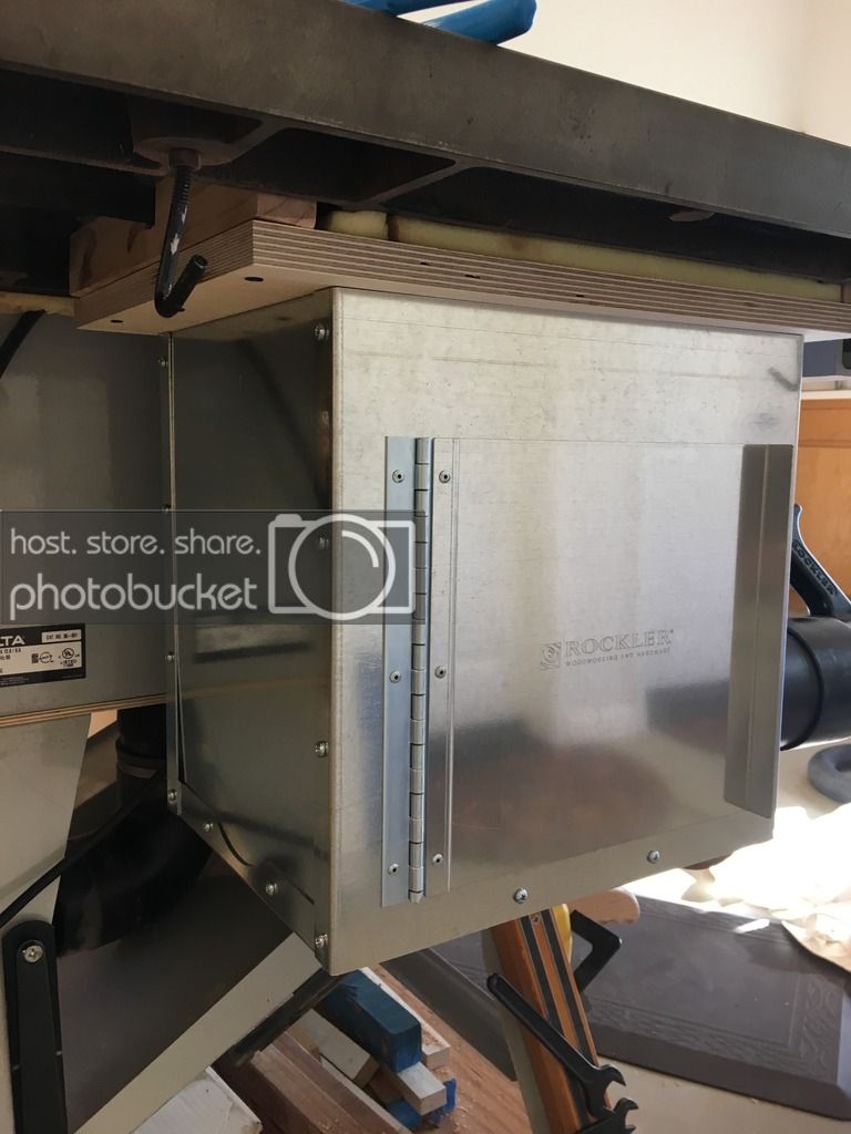

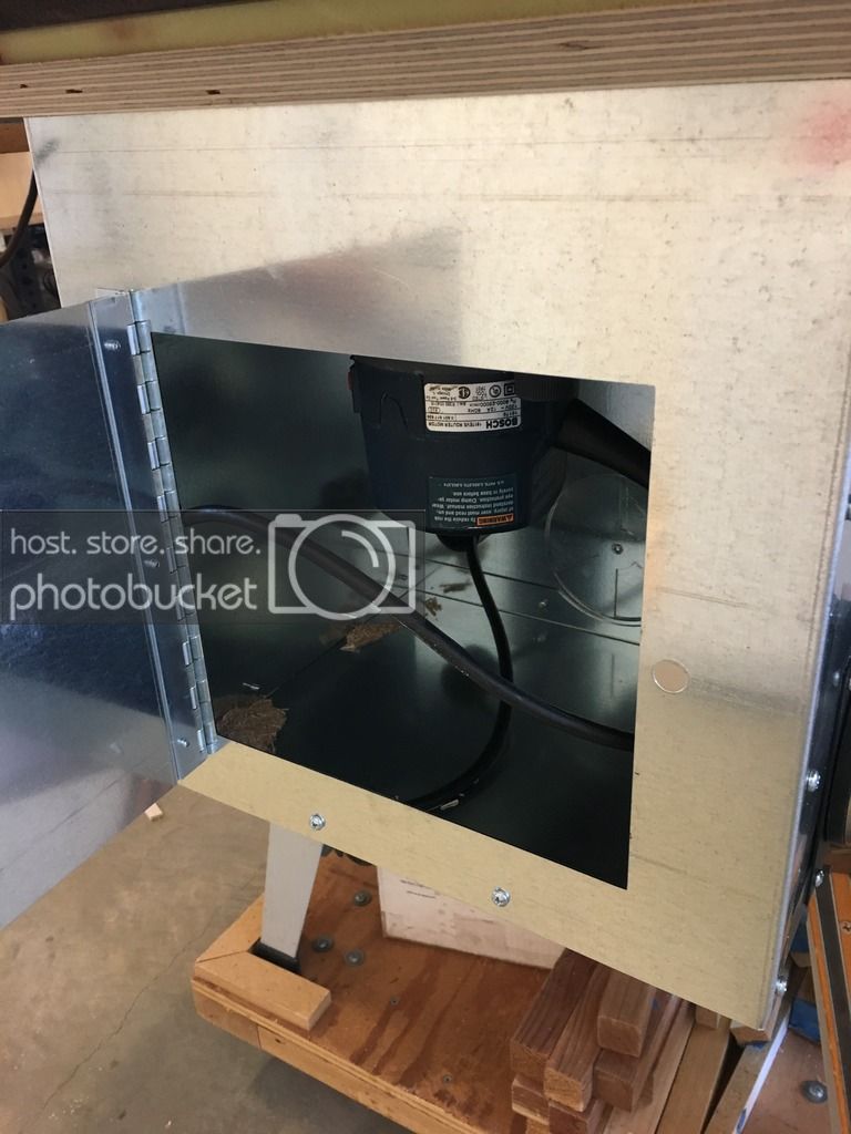

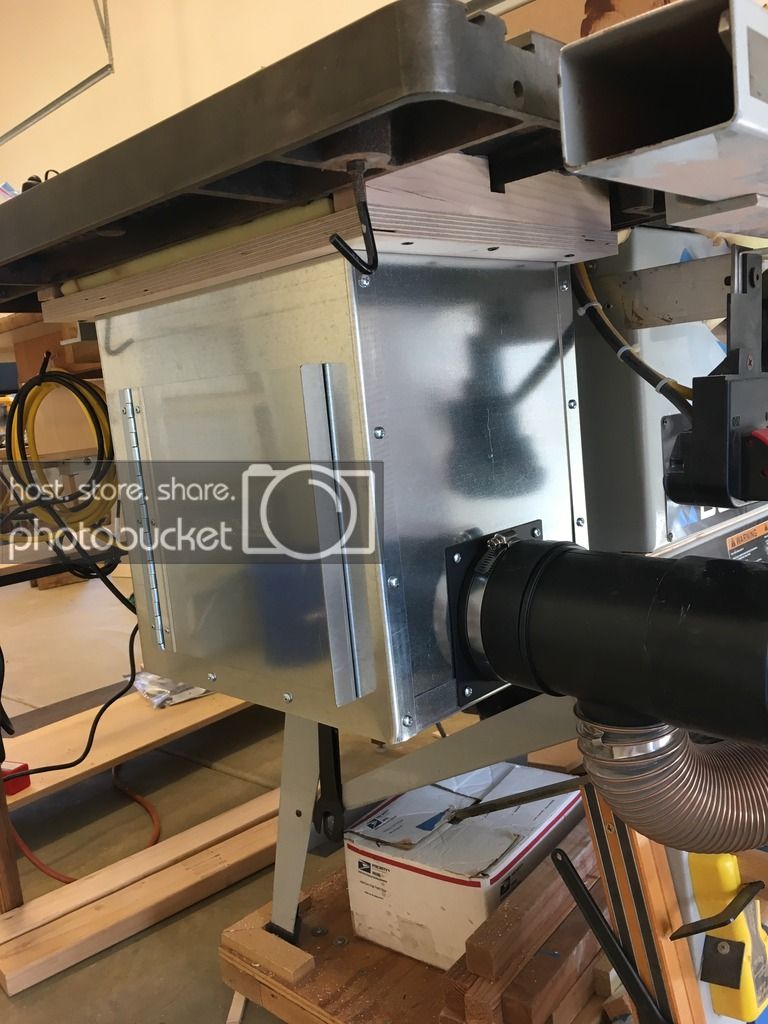

Thank you Rockler for their Router Table Dust Collection Bucket. It was a chore to attach it to my cast iron Benchdog router extension wing, but it was worth it. Next to the initial steps in turn large spindles round, my router table was the biggest mess maker left in my shop. I needed to affix pine strips to the underside of the Benchdog wing with extra strength construction adhesive, but after that it was easy to mount. Access to the router is different, but convenient.

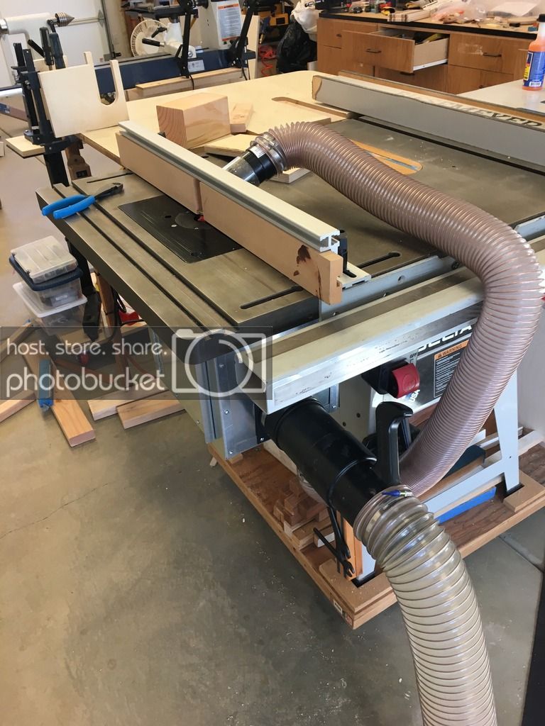

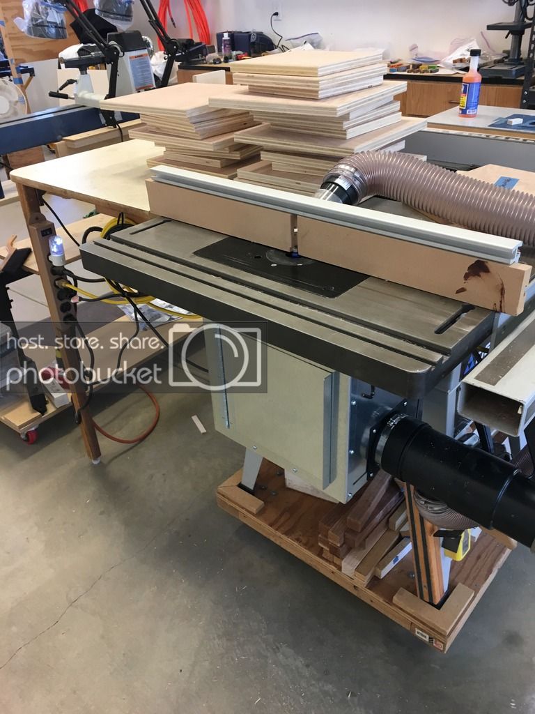

The photos show the overall look with the fence mounted dust collection all feeding into a removable Dust Right connector and 4" hose. The stack of wood, a whole 4'x8' piece cut into pieces, was edge routed with on a tiny amount of stray chips to vacuum up. The collection bin was virtually empty after routing too.
