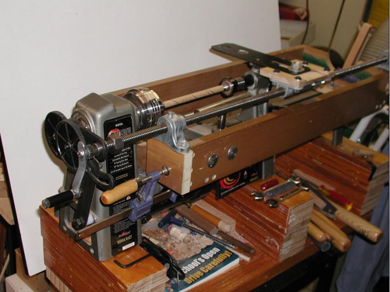

Router lathe version 3 or what to do with all the extra gears that come with a mini metal lathe.
This setup will do .5 TPI. The router mounts to the bracket attached to the lead screw. I just attached a pencil to draw a test path.
Next up, add a reciprocator then on to CNC?
