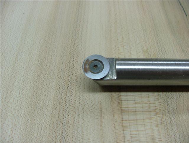

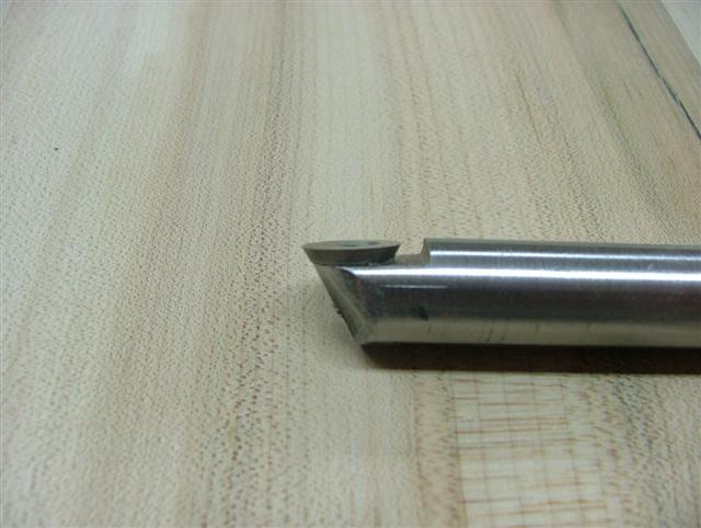

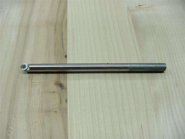

I made this one. Bought the cutter at Lee Valley and a piece of round stock at Home Depot and filed away until they matched. Turned a handle, used a copper plumbing cap for the ferrel and it cost me a grand total of about $20 of which $15 was the cutter. The picture is before I put a handle on it.
I know you don't have Lee Valley or Home Depot but for the cutters maybe see if Global Tooling will ship to you. I haven't looked in a while but I believe they have the round cutters for a lot less than the Lee Valley one but I think they have a minimum order of 10. Still way cheaper.
