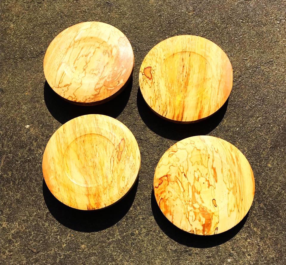

At the last meeting of the Richmond Woodturners we had Mike Mahoney do a live remote demo. Among other things he talked about the best Woods for bowls and platters and how to prepare and rough out blanks for platters. I had a big chunk of beech laying beside my driveway and decided to try my hand at some platters. The beech has some nice spalting. I coated my roughed out platters with poly vinyl acetate (Elmer's glue) for drying. I cut some blanks for matching salad bowls that I hope to rough out in a few days. I also cut some pen and bird house ornament sized blanks from the cut offs.
Nicely done!

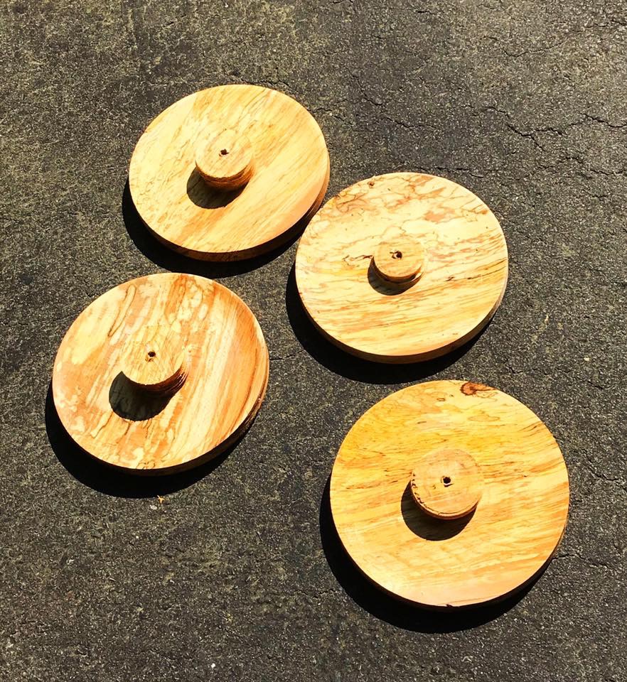

I recall seeing a video where he left the tenon on roughed out bowl blanks. Does he recommend that for platters as well or is that something that you decided to do? Any thoughts or experiences on the pros and cons of leaving them on?
He recommends leaving the tenon for platters as well.
