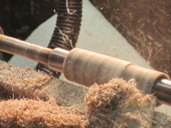

Ok lets see. first after using Charlies pendent mold ( I Can Not say Enough great things about his molds!) and loving it I tried to turn it and wow just like glass shards everywhere and ouch ouch ouch...
Than I turned my own casted sprinkle blanks and BANG BOOM no more holiday sprinkle blank after that explosive blow out on both sides!

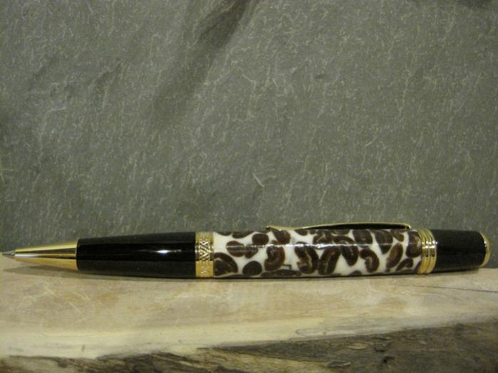

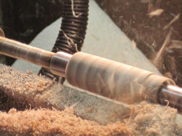

3rd times a charm after dumping ca all over both hands gluing up a coffee blank from Fred I than decided I had enough trying to get Ca off. So I decided for round 3. Pictures tells the results of me and My new skew I got as Christmas gift! :biggrin:
So Please Tell me the good and bad of how you perceive my Night of turning ended. Thanks!

Wow, Karin! What a beautiful pen! Great finish, too.
Those coffee blanks aren't that easy either.
The Pen Looks Great! But that looks like a huge bite to take at one time with a skew, but then again it just may be me I am kinda of chicken with a skew. LOL.
Thanks. I was not sure on finish so I slowly added 10 coats of CA did not matter I was already covered in it.
As for the bite well it kind was more a catch and with my night I went with it slowly and tried very evenly and it worked this blank was not at all brittle in any way so I think the blank allowed for the bite to be that greedy and get away with it.
The skew is now becoming my friend and I am starting to do a lot of my pens with only the skew hence the new gift. :)
You got more intestinal fortitude than me. If my shop time starts going left, I quit. Otherwise i usually get mad and break stuff.
I too use the skew on all my pens. Just remember the skew may feel sharp being new but it can be even sharper and sharp is the key word. Always use a sharp skew. As far as the other things blowing up, maybe the skew wasn't sharp if that was the tool of choice. Or the blanks were just too brittle and too much hardener was used. Needs investagating. Good luck and good job on the pen.
One other note, evidently you do not have an adjustable mandrel. That is alot of spacers. I would have gotten the blank closer to the head stock and if I had to put the spacers on the tailstock end. Might want to look into an adjustable mandrel or try turning between centers. Just a thought.

Eenie Beanie Coffee Beanie!! You survived and scored a real nice pen to boot! You didn't glue your hands to anything so I would say that you did great!!

The coffee bean pen looks fantastic, those are big cut you are taking in the first 2 pictures, make sure you have sharp tools and take very light cuts, this will help preserve the blanks a little!
What are you using to polish the CA? I think I can see some lines in it. Micro Mesh wet to 12000 grit will make it shine. I might also suggest that you use the skew a little differently. It looks like you are using it like a scraper, and it is really designed to be used for really light shearing cuts. Your shavings should look like whiskers, no dust at all. Check youtube for skew instructions. Ed also listed a video link recently, calling it a dirty video. I prefer to not put any CA on the coffee blanks, the smell lasts longer.
