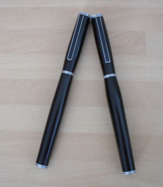

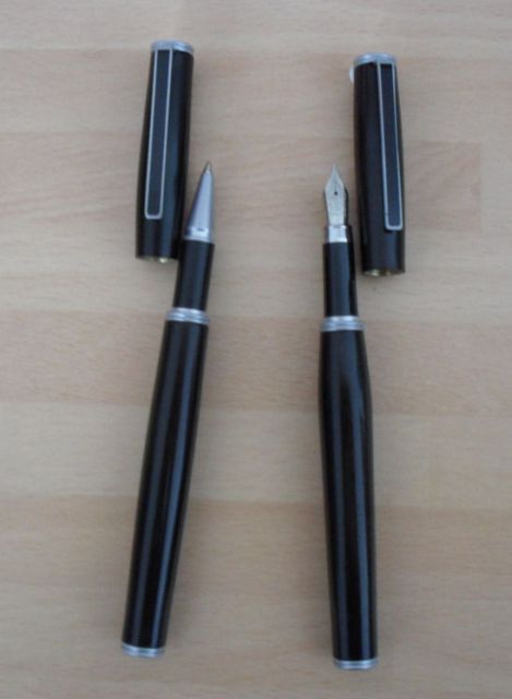

Just finished this Rotur Fountain and Rollerball kit.
Wood is Ebony and the kit finish is Satin Chrome.

I like the simple smooth lines and simple trim. You did a nice job on these. What finish did you use? What is the kit and where do you get them?
It looks like CSUSA's Artisan. Man, do I hate that kit.
If I may ask, why? I haven't done one like that yet and wonder if there is a reason I may avoid it, or what to look out for if I try.
I don't care for it for two reasons.
First, it uses a plastic insert to hold on the cap. This insert is kind of finicky to get installed perfectly correct and leads to maintenance issues.
Second, because of the way that the cap snaps on, there is no 'center band' insert pressed into the cap. This is an issue for two reasons, in my opinion. It leaves an unfinished edge of the blank visible and the raw edge of the tube can scratch the plastic nib section when the owner removes/replaces the cap.

@sbell111 2 good reasons why I won't be making any more of this design.
The shape is also bad but is a beginners error as explained by Walter on page 40 of his book.

Thanks again for the comments guys, but I am thinking of disassembling the pens and turning the outside paralell. I was given this kit and will see what my friend says next week at the club meet.

I probably wouldn't do that.
Their current shape isn't displeasing and by turning it down farther, you are just giving the ebony an excuse to crack.
