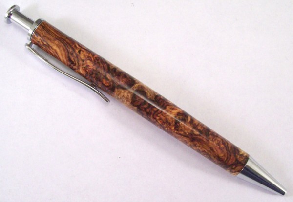

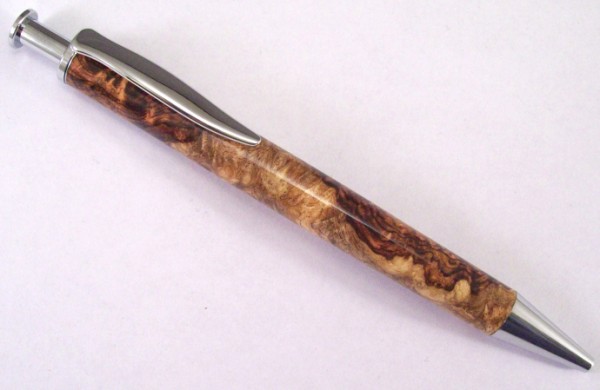

The first one is a Rhoidum clicker made with a nice piece of Rosewood Burl I got from Rodney Rice aka wolfdancer.

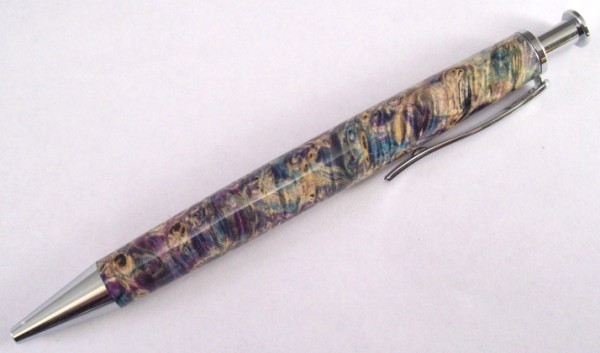

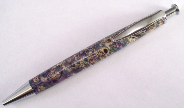

The second pen is also Rhodium made with Violet & Teal Double Dyed Box Elder Burl. I added blue Transtint Dye to the blank prior to final sanding for a bit more color. Its a very busy blank, but I kinda like it. Both pens finished with CA/BLO

Very nice pens. I liked the double dyed one. How did you apply the last coat of dye to the blank. Did you turn, and then rub the dye into the blank? Dyed blanks can be real nice, but look alittle washed out after turning. An addition of color at the end may be a real improvement. Thanks for showing your pens.

Bob, I turned and sanded the blank then applied the Transtint and re sanded to 600 grit. Then finished as normal with BLO then CA and Micromesh.
