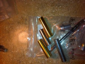

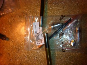

I Just checked
I just double check my Olympain Barrel Trimmers and they fit my Roman Harvest tubes just fine.
Could I have spun them once around the lathe with sandpaper? Possibly, because I no longer make the Olympian. BUT, the trimmers don't look sanded.
