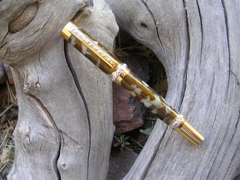

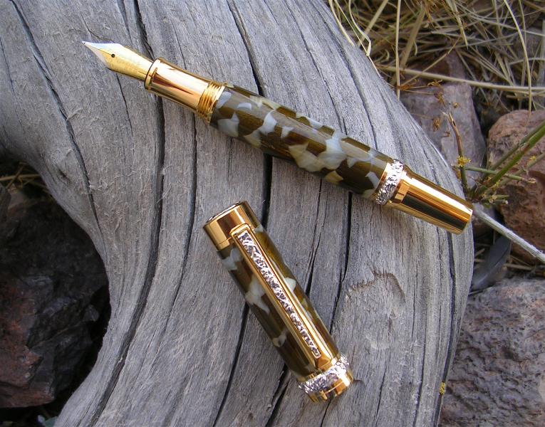

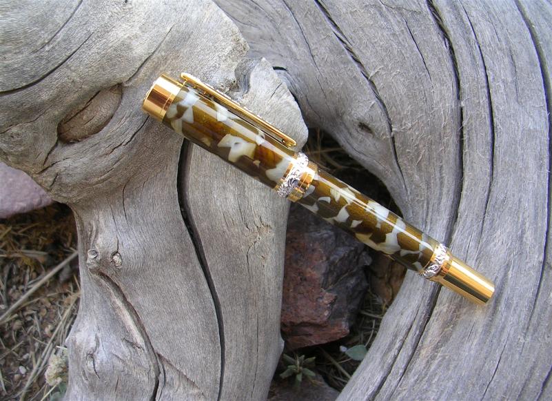

I was dying to use this translucent calico blank I got from Classic-Nibs. All in all it went pretty okay. I was undecided on what to back paint the blank with and made a poor choice. I probably should have painted the tubes as well.
I used a metallic bronze. The metallic powder or specks in the paint is detrimental in my opinion. It sure sounded like a good idea at the time. Live and learn. It will make a good everyday clunker unless I take it apart and turn something different for it.
The translucent blanks are a bit of a challange for me. I did lightly hand sand the blanks after drilling to remove scoring from drilling. Perhaps a simplier approach next time might work better.
Another speed-bump in my pen-turning adventure I suppose.

Sounds like a bit of work went into this one....came out great from my chair!
And I like the coloring of the reverse painting too!

I'd have to eye it in person to see what you're referring to...the pictures aren't able to carry that level of refinement (IMHO). As far as I'm concerned that is one fine looking pen!
The pen looks great in the pictures.
However, I can relate to the coloring woes. I too have experimented with paints, and recently used Metalic Gold to reverse paint a very translucent blank, and the result was less than desirable IMHO. In my case, I think it actually would have looked better had I just used bare tubes.
