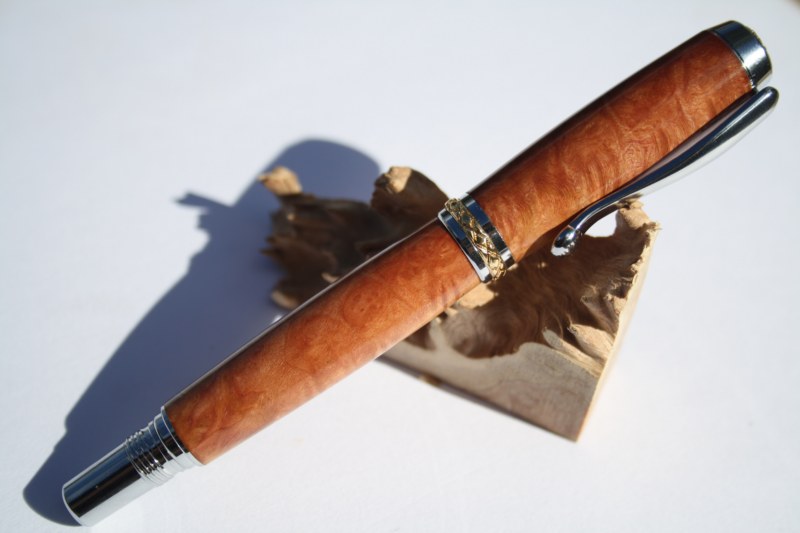

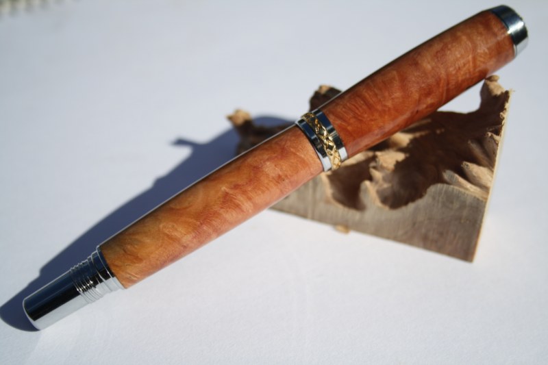

heres one i turned up the other day, triton rollerball with some of rockys manzanita burl.
first itme ive turned manzanita and wow! this stuff is so sweet to turn.
i cut the bottom tube in half and glued it in each end of the bottom blank leaving a 6mm gap between, making the bottom blank slightly longer.
i recon it makes the pen feel and look so much better, only thing is you need to replace the spring with a longer one also.

Ben I have driven in stretch cars indeed my old Mercedes could be called that. Your stretch pen creates a neat design, goodonya for having a go it pays in satisfaction.
Typically you shared the spring thing, I am a stranger to Manzanita its locations etc , it sure looks great. Keep on with your special pens.
Take care Peter.
