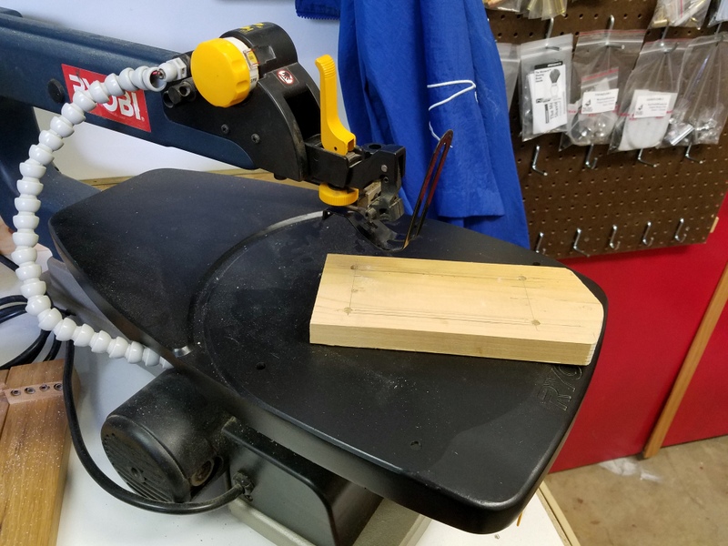

Anyone own one of these? I bought this saw many years age and only used it a couple of times. Today I was trying to fabricate a thin strip jig for my table saw. It requires two slots 1/4" by 5". Not owning a router I attempted to make the slots with the scroll saw unsuccessfully. Perhaps the wood is too thick or the blade is wrong. What ever the problem everything vibrated like crazy and the cutting was incredibly slow. Blade speed was about 500 strokes per minute. Perhaps that was too slow but I was a little gun shy to go faster. I scrapped the project. My mill is only 2000 rpm, too slow and I don't like sawdust around my metal machinery.
Anyone have success with the Ryobi Scroll Saw?

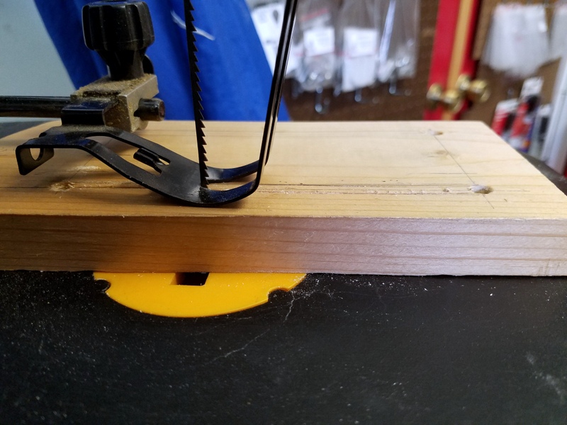

I make slots with the same method you are using when I don't want to take the time to set up the router table. I have good luck doing it this way, and from your description and photos, i see three things that could be the problem.
The wood is well within the capacity of the saw, but the speed should be as fast as the saw will go. This will actually smooth out some of the vibration. Fast speed and a slow feed will get a lot smoother job than the slow speed cut.
Also, it looks as if the blade is touching the back of the slot in the hold down foot. This will cause the blade to heat up and possible break more quickly. It could also cause more vibration.
The last thing is that it looks like you are using a pin end blade, which don't work so good for me. I use the plain end blades, which seem to me to cut a lot better.
Thanks Jolly Red. I'll give your suggestions a try. I was afraid to go faster. Thought the saw would explode. I only had the pin type blade with a course tooth count. That will be remedied tomorrow. Also there is a micro space between the blade and foot but I suspect when the blade flexes it will touch. I'll also correct that. Thanks again.

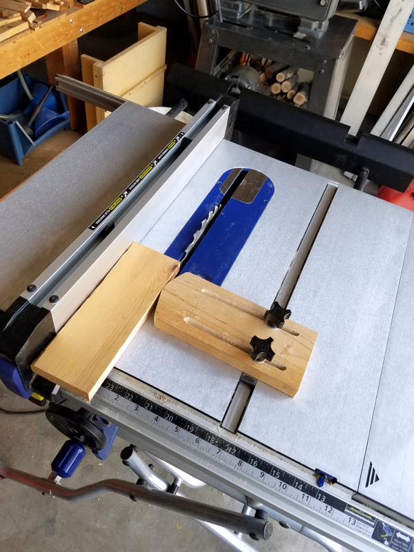

Hi John. I did follow your advise and finished my thin strip jig. The Ryobi sort of did the job but it is a very unsatisfactory tool. May end up on the curb. You have a Hawk. I see a 220 VS on Craigs list for $300. I don't know the condition but seems like a good deal. My project turned out a little crude but will make the next one from aluminum. I did find a bunch of blades.
