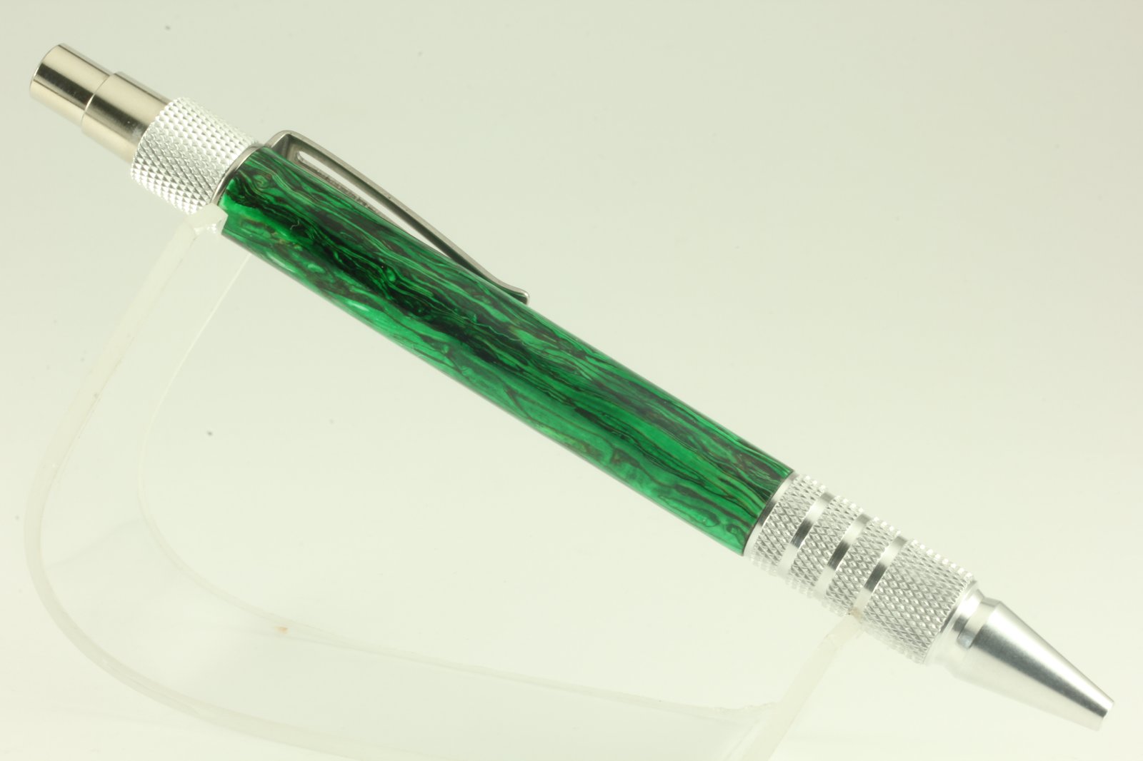

I tried food coloring and it worked well. Here's hemp with green food coloring: IMG_3046.JPG
