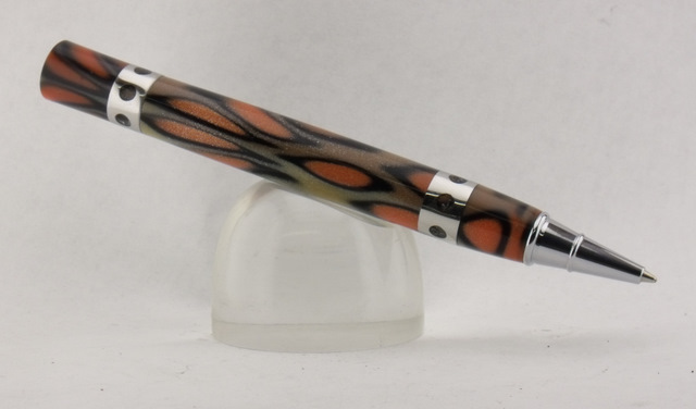

Just a slightly modded cheap UK kit with an 'Orange Glow' ( stupid name!! )blank. I made two little stainless rings and index drilled them just to add a bit of bling. :biggrin:

The banding is extremely inspirational. I can see the blank below it, so that means you spun the bands super thin and just slipped them over the top right? What holds them in place, a touch of epoxy? Even though they barely are higher than the pen and I can see that you nicely softened the edges, does it feel at all odd in the hands? These are the things I sure would like to know Steve, thank you.
Oh..when you put a rod in an index to drill it, do you have to punch it to stop a bit from rolling off center or will a center pilot bit still stay on course?
Jeff, the banding is flush with the blank. I turned tennons to take them. But they are pretty thin.
Indexing the holes was pretty straight forward. I drilled them in the lathe while still a fairly long tube. I made a clamp for a drilling machine ( also fits my small router) and used a centre drill. The little pip on the drill was plenty long enough to pierce the metal before the countersink part touched. The clamp is held in the tool post and is adjustable to make sure it is on centre height. Easy :biggrin:No punch required:wink:
The top band does have the edge smoothed as this is where the mech twists.
