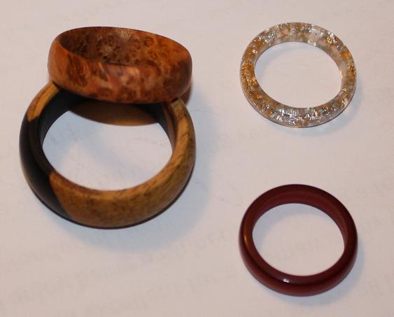

In response to the inevitable "pics or it didn't happen", here is the offender.
The African Blackwood is mine, the cherry burl on top is for my wife, and the two smaller ones are for my nieces. One is copper madreperlado and the other is one of DurocShark's gold/silver mix blanks.

Wider rings need to be a 1/2 size larger than std rings and in the jewlery business they are often curved on the inside like the outer shape on your rings. (Comfort Fit) Really wide ones can be a full size larger(or more). In a thinner ring your flesh will slip around the ring as it is slid off.
I had the outward facing side curved already, but I figured I would check the fit before turning it around and facing off the back/putting the curve on the back.
Lesson learned in blood.
Interesting about them being oversize. Are they just made larger for a given "size"? Or is it just recommended that you buy a larger size than usual for wider rings?
There are tools for measuring your ring size. they come in standard sets for rings up to 3mm wide and wider sets for rings up to 7mm wide. Its recommended that you buy a larger size. The sizes have a specific diameter regardless of the width of the ring so a size 7 on the inside is the same no matter what. The wider the ring the larger the size it will take to fit.
I thought the sizes were fixed based on the ID.
I have never seen a set of the wider sizing sets. That would be handy to have.
Sorry, yes they are based on the inside diameter of the ring. I had to order mine from a jewelers supply house.
