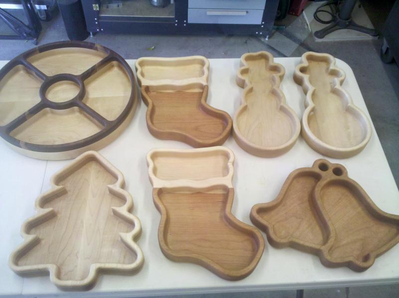

I have the rigid, and I use it for making my Bandsaw boxes, my candy trays, and regular flat work. Its a good all around tool.
As far as squaring blanks, I guess it will work for that, but I don't square my blanks that way.
On the bump in the belt someone above mentioned, lower cost belts will have that overlap, the same with any size belt, if you buy good quality belts, then that not there.
Here is a pic of some of the trays I do on the rigid. I don't have any of the bandsaw boxes on this system. But I say it's it a good tool I use it.
