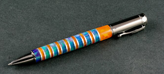

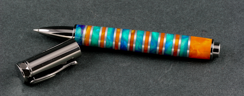

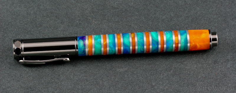

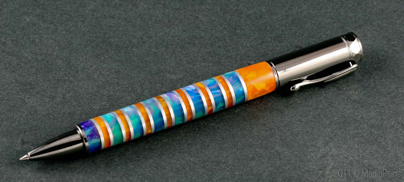

This is my first time working with metal. It would have turned out if I had gotten the layers on straight. Oh well, it was a learning experience.

Hey, if you don't like it, I'll be glad to pm you my address. That is a pretty impressive pen, especially for a first try. That is what we call tolerance stacking. All the slightly thick sides ended up on the same side.
Charles
I think you cut the acrylic with a saw. If I am right, next time round off the blanks on the lathe and cut on the lathe.
Looks nice. Good ideas there. It wasn't a mistake . It was a learning experince that turned out pretty darned good.
Those colores look great together.
Fish
I see that last piece of yellow, looks like maybe a piece of dirt got in the joint..glue too thick, not clamped right there..somethings up in just that one spot. I don't blame you for not being satisfied with that..I'm the same way. I've tossed out thousands of hours of labor I'm sure. But...like everyone says...you live and learn, examine the mistakes and move forward.
I can see what you are talking about with it just being out of the perimeters you set. But, it did take me a moment to notice. Looks like a fine daily driver for a while. Good Luck on the next one.
Thanks everyone. My daughter loved it and now has it. I did cut the layers on the band saw, but I have a slicing blade that I can cut veneers with, so that wasn't the issue. The aluminum was uniform. I noticed that when I started stacking from the tip side that I didn't compress the second layer evenly and that translated throughout the rest of the pen. I also goofed the last layer. If I had a block of delrin I would make a compression tool. I like the process of trying to get it to all come together. I didn't set out to do this initially - I was drilling a piece of acrylic and it broke, so I was just making things upnas I went along.
