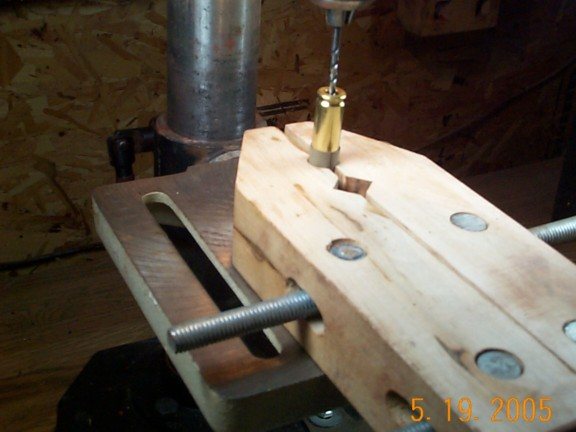

Here ya' go.
<br />
Drilling a two step hole in the clamp will keep you from pushing the shell all the way through. I wrap some 4oo grit sandpaper (grit towards shell) around the shell. I always use some oil in the dimple too. It works great.
