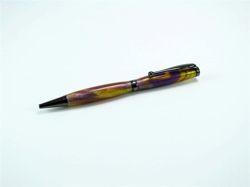

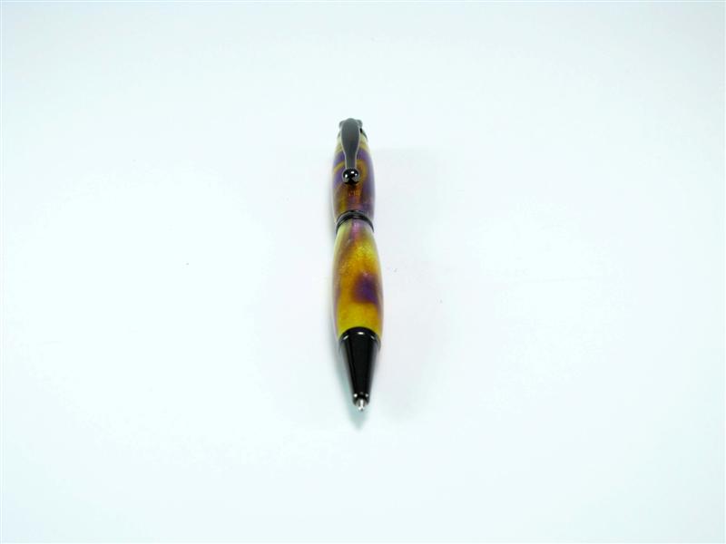

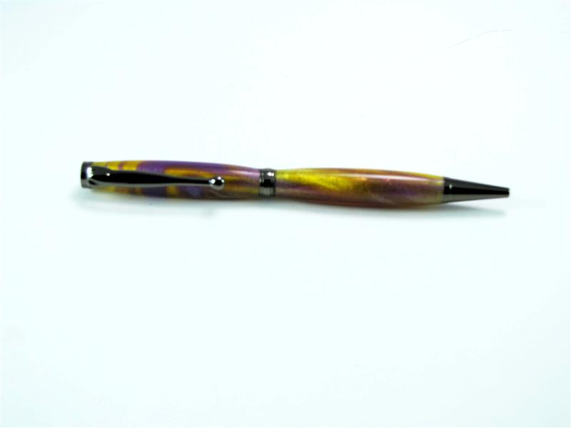

I turned my first RhinoPlastic blank this weekend.the color is called Tiger Swirl(Go Clemson!!).It turned as easy as any other acrylic I have turned.I have only turned about 12 pens in acrylic so far.This did not seem any different.It does take me longer to turn an acrylic pen than a wood pen but the difference in time is made up by just polishing and not having to apply a CA finish.
The RhinoPlastic sanded/polished well with micromesh and Novus2 plastic polish.
I bought a half dozen of various color blanks and I am looking forward to turning them soon.
My tooling is a mix of carbide insert tools and a HSS round nosed scraper.
Andy
