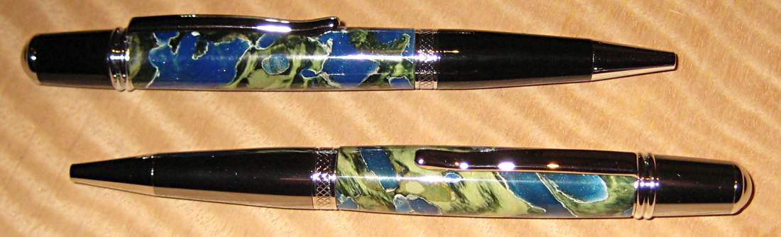

is the blank I started with <s>; I'll post the pen in a while</s>
and this is the pair of pens I ended up with:
The two-tone Platinum is mine :D ;)
Holy cow, those turned out really neat! That's the first pens I've seen turned from those blanks. Very nice work, and thanks for the great review, I'm glad that they worked out so well for you. :)
Back to casting for me! I have to get another batch posted, my poor 'showroom' has been emptied out. :)
Thanks for posting this Gary. Personal taste I like the top one better. The green is a little darker and looks more like the Google satellite shots and the bottom more like the Google terrain shots. Either way they are awesome blanks and I think Karl has concoured the wraskly wesin.:D
Great job Gary, now go give the other one to your wife.[}:)];)

My hat's off to Karl. I have turned a couple of his blanks and am very happy with the results. I was worried about finishing. I like to wetsand acrylic and dry sand and finish wood. I "damp" sanded the blank up to 12000 MM. I finished with Ren Wax and was happy with the result. I'm getting more.
Syd,
I used a CA finish on these because of the wood/resin combination at the surface.
Using CA, I could be certain the blank will feel smooth and hold up as well.
The blanks are fantastic though -- that's for sure.
