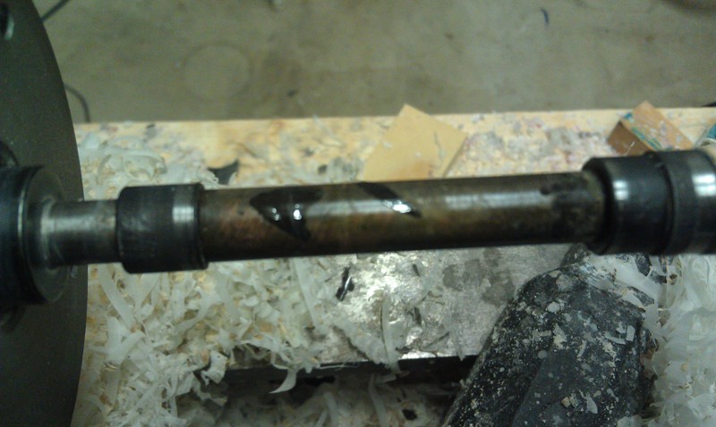

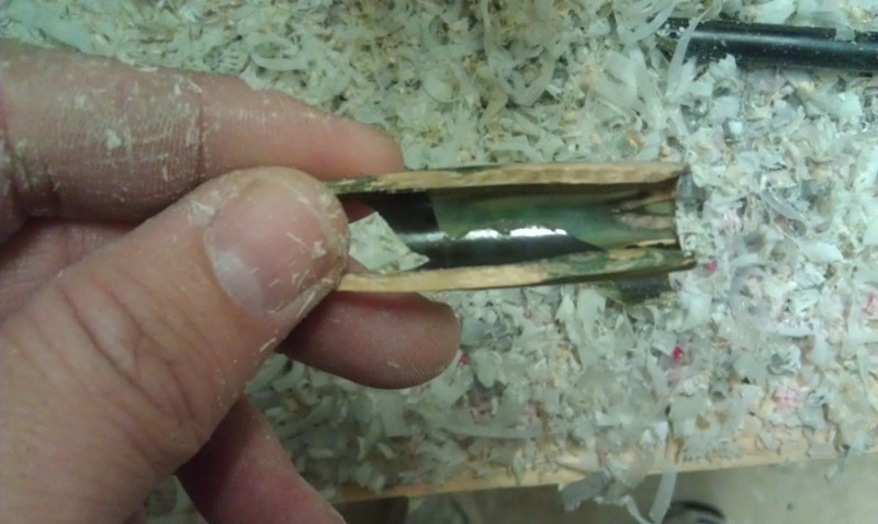

All,
I need to take back what I said about Blacken-It. I just blew very nice blanks! The stuff doesn't change the actual color of the brass. Instead it creates a coating that doesn't bond well enough for turning. I took these pictures to offer as proof.
Sorry if I caused any trouble.
Thanks,
Tom
