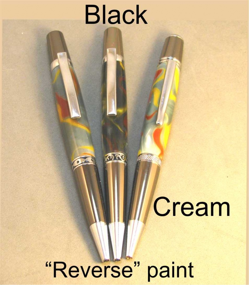

In case you do not get our weekly email, here is a comparison of one pen blank (our Liquid Metal blank), with the drilled hole in the blank painted (reverse paint) a few different colors.
attachment.php
The pen on the far left is reverse painted grey. The picture is a little lighter than real life, cause monitors tend to darken the pic.
Happy to answer questions, if you wish,
Ed

Thanks for your photos of examples, Ed. I do get your Sunday Missives but it is nice to see this again here ... enlarged, I think.
If the color is affected that dramatically by the paint color, the blanks have to be very translucent.
When I cast, I ensure that painting will not affect the colors, at least not to that degree.
Maybe it's the pic, but those blanks don't appear to have any depth and look as if solid colors were used in casting.
"Depth" is created by using translucent colors. Opaque dyes will cover the tubes much better.
I've done that blank at one point... I'm pretty sure its the picture.
Ed - I suggest trying another picture for this thread. Focus on the blanks, not the whole pen. Put the 3 pens in a line, clips off to the side (or under) - and get a straight on shot. It would be a terrible picture for showing off the pens (your first one is set up pretty well for that) but I think it will do a better job of showing the color variation in the 3 blanks and the depth of the blanks.

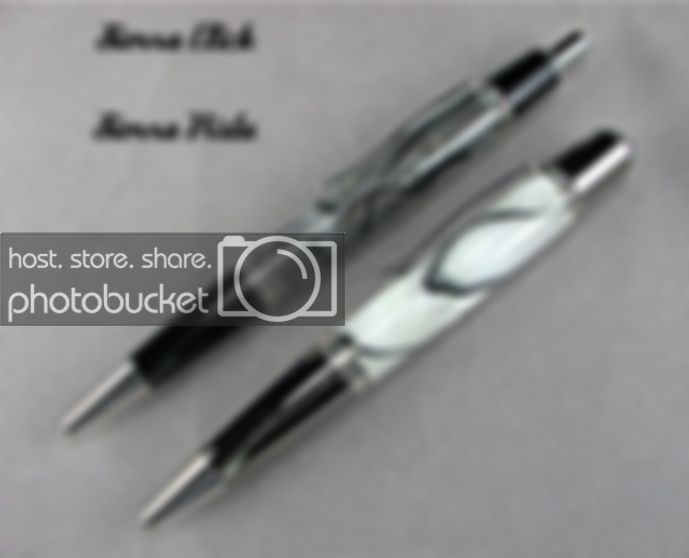

For me, the best blanks have a variety of colors, yes. But there has to be some amount of translucency to them for it to have depth. If you can't see through some of the colored blank to lower colors, there is no mixing. There are many blanks that mix colors, but no depth. Note, that doesn't make them bad - quite the opposite, some are GREAT with no depth. I'm not arguing about any blanks, just the definition of depth.
Examples:
Black pen has good colors, almost no depth.
Red pen has good colors, pretty good depth (see parts of the white lightening the red)
This blank (one blank, two painted halfs) has lots of depth.
In the 2nd picture, the back paint affects the look, but its definately NOT all you see!

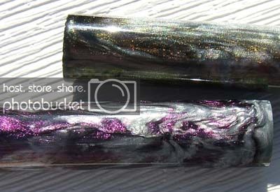

This is an example of one of my blanks. If you look closely, you can see the swirl and overlaps that actually introduce other shades and colors that help the 3D or depth. It's difficult to get the 3D effect of depth on a 2D monitor.
When the blank is moved and rotated, the purple seems to disappear behind the white and as that happens, there are shades of purple and blue along with the white showing darker shadows. It also looks as if there is black in the blank, there is no black. It's created by the colors swirling and overlapping to create a dark shadow in the purple. All of this in combination, creates depth. It seems there is no bottom to the colors.
Maybe I'm not describing it correctly, but if you had this blank in your hand, you would understand what I'm attempting to convey.
