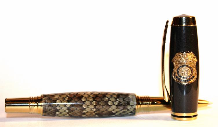

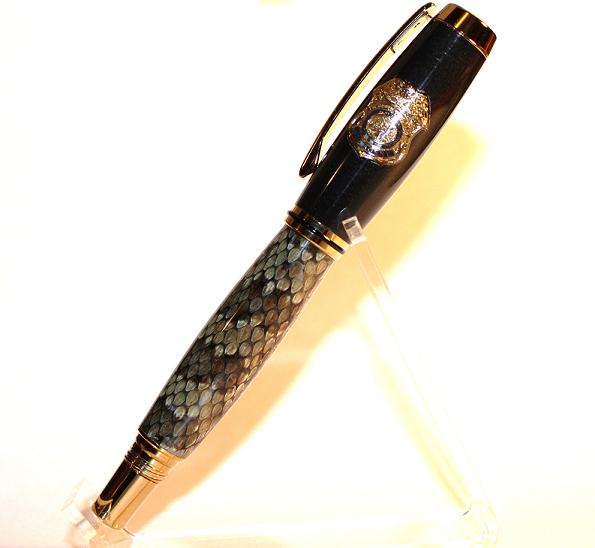

This was my first attempt at casting. It is a gift for a friend who is retiring after 30 years of military service.
The trick was getting the badge thin enough to bend around the tube without cracking, second trick was not going through the PR.
Dale

OK Dale,
I just have to know more about how you did this. That pen is awesome. First off, where did you get the badge? How was it prepared before casting? These are the kind of pens that absolutely amaze me. Being new to turning, I am constantly taken back by the things that people on this site come up with. Excellent work.
Dan

Dan,
The badge is a tie-tack that I sanded down to about 1/16th of an inch. I then bent it using a punch the same size as the tube; I placed the badge on a block of wood with a groove slightly bigger than the tube and carefully tapped the punch length wise on the badge. This bent it for a perfect fit around the tube.
The tube is painted with a slightly textured black paint and the bottom is rattlesnake.
Using the tutorials on casting and snakeskins was a big help.
Dale
