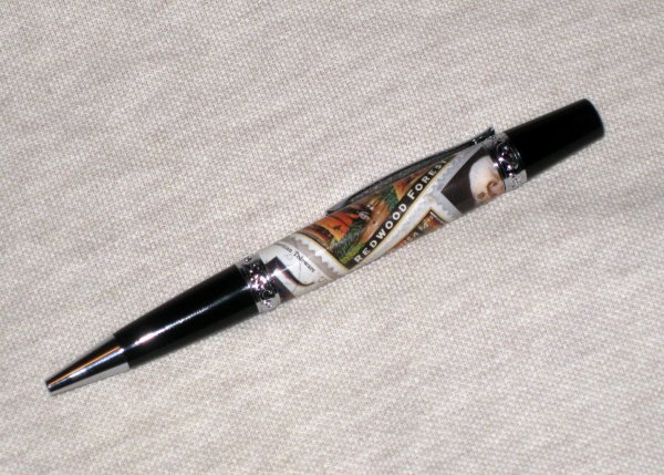

My mailman is retiring. He tells me I'm the reason he now has a bad back due to the boxes of pen supplies he keeps delivering.
So I decided to make him a pen with some of the stuff he's delivered.
This is my first attempt at making a stamp blank. The stamps are from packages he delivered over the past few months. Since I don't cast, (yet but give me time). I fixed the stamps to the tube and started building up coats of CA. How many coats? All I can say is lots, I lost count.
The kits is a Le Roi from Smitty.
Hope he likes is and that his back gets better. :biggrin:
