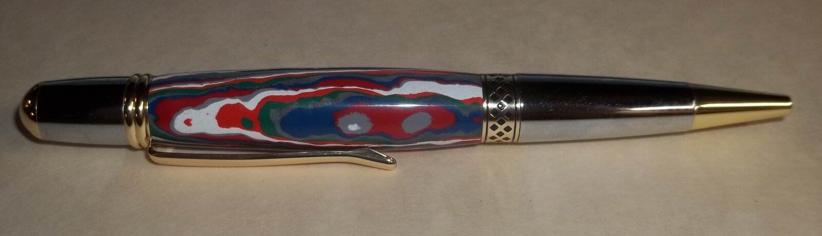

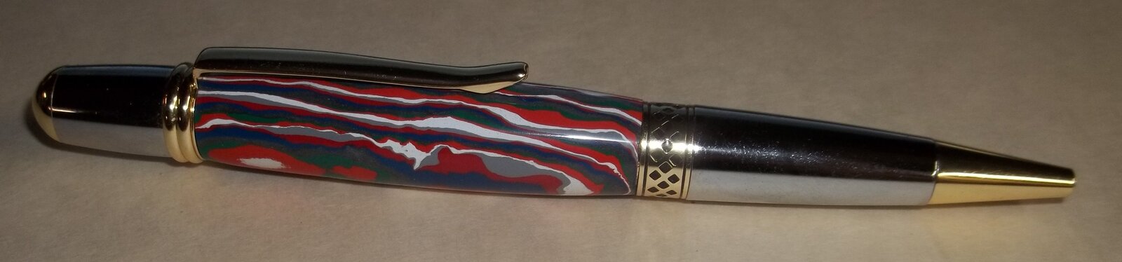

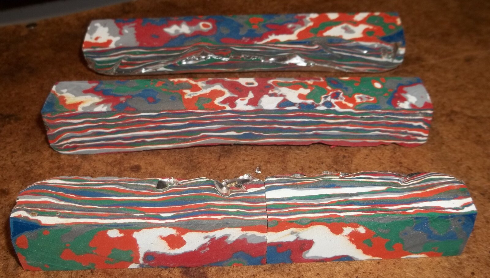

Results of my 3rd attempt at making fordite
See more from pssherman
pssherman
Jan 19, 2006
845
Paragould, Arkansas, USA.
Here are the results of my 3rd attempt at making fordite. I used a hot plate to heat the mold from below to continuously flow out the powder as I sprinkled on each layer (56 total layers of powder coat powder). I did not find any noticeable bubbles this time. If there is any interest in buying blanks like this let me know and I will make a bigger hot plate so I can use a larger mold (9x12.75 inches).
There are 7 different colors of powder used to make these.
