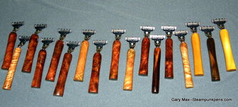

Finally got this taken care of-------Restocked for a big Christmas show
Mach 111--- I buy them from my friend Anthony Turchetta

I've never made any razors but have thought about it. Does the wood hold up to the water and soap okay. I shave in the shower (others might as well) and always wondered that. Those look very cool.
They are sealed and don't soak up water. Mine is about two years old and still looks fine----not that it gets a lot of use since I have a beard. But I do keep it trimed. I also use wood the doesn't really soak up water.
Rosewood---Coco---Osage things like that.

Lovely bunch of razors, I did two of these the other day. Most work for me was getting the old handles off to replace.
I epoxy the heads in---they don't come apart ----the only thing your can take apart is for changing the blade.
Yip, I use epoxy as well. When the outer rubber is off the handle and its apart. I cut the brass pin down a bit and glue the turned wooden handle onto the head using the pin.

Would you mind telling me what you seal them with? I have to make 5 for Christmas gifts and was thinking I was going to have to make them from acrylic. I have lots or wood blanks but am afraid the water will ruin the wood.
Thanks, Scratch
Don't tell anyone but I do it the easy way-----I made all these in one batch and shot them with lacquer--- you can buy the rattle cans at about any hardware store---I like the high gloss---these have three coats--sand with 400 between each coat.
THANK YOU!!! I already use Lacquer for finishing my pens.
I use Magna Max lacquer with a HVLP gun from Harbor Freight.
When I sprayed with a can I got orange peel every time.

The razor handles I have made from Acrylics, Trustone and M3 are perfect for the conditions the razor will be subjected too. However it's hard to beat a nice wooden handle!
When I turn a razor with a wood handle I simply dip the handle in Marine Spar after I have completely finished the handle on the lathe. The one can of spar I purchased seem as though it will last me a lifetime. So far this method has protected my wood turned handle razors and brushes completely.
