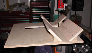

Attached is a picture of a sled from the Yahoo Penturners Forum library. Hope it helps

Thank you all for the comments. We are going to look into making a sled. But I am assuming this is for cross cutting. Is there a sled for ripsawing or is this not necessary?
I use a simple sled and various size furniture clamps for both ripping and cross cutting logs, on my G0555. There are any number of bandsaw sled plans on the internet these days. Mine is a less sophisticated copy of one illustrated in American Wood Worker.

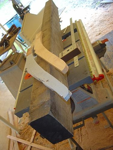

Resaw? Almost every day. You want a wide blade with a low tpi count. This old WO Navy Yard 4X7 bearer is about to produce some replacement frames:
Basically, I find any fence is a waste of time if the saw and blade are tuned. Any long fence must be adjusted to match the blade track and readjusted with every blade change. Blades track in one direction or the other away from your layout line because their tooth set isn't perfectly matched on both sides of the blade.
I generally fix the blade track and use a chalk or pencil line followed by the thickness planer and have little trouble, tho I don't go thinner than my small planer will handle. I might make myself a point fence if I had a large run of thin stock to get out, however.
One reason I don't like gluing anything but a perfectly-planed surface, besides not liking to be so fussy (and slow) resawing exactly to a mark, is that it takes a whole lot more glue to fill those saw marks. And with a glue that doesn't fill gaps well (which is just about all of them short of thickened epoxy), there may be trouble ahead for that lam.
