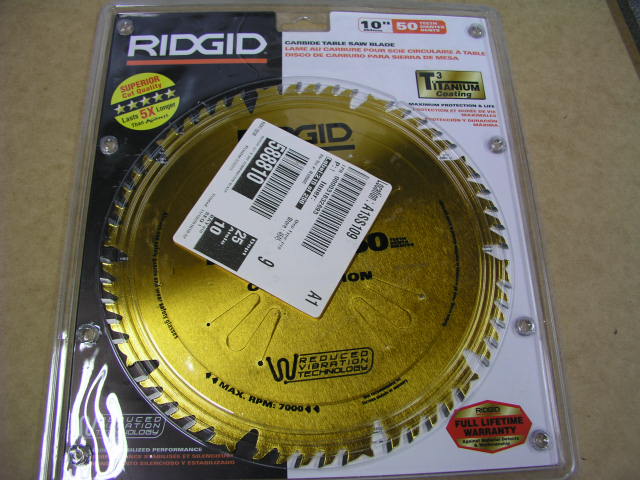

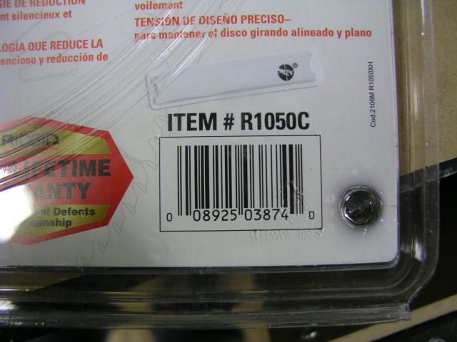

I have the Ridgid blade kludge77 spoke of. Home Depot has them for $40 here, and occasionally they go on sale for $30. I have one on my table saw (and one spare), and its sweet for the price. Made in Italy (Freud), leaves a great edge and cuts so quiet i never hear the blade cutting on thinner material. Not sure about thicker material, i usually use the miter saw for that stuff.

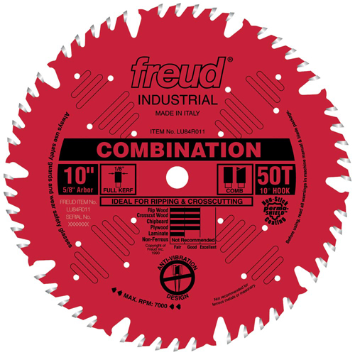

I'm undecided between these two blades... any final input before I purchase today?
$59.99 at Rockler
$29.99 at Home Depot
Any final thoughts???

Top one, top one, top one. This is a combination blade and is more useful, not that you couldn't cut with either one. I am not sure on the kerf size on the bottom one either. Remember to make your blade last longer clean the carbide off once in awhile to get rid of the resin that builds up especially from cutting oily woods. You can probably beat that price on Amazon.com or just type in Freud blades in google and you will find tons of places that sell them unless you are just looking to walk in a store and buy them. Lowes or Home Depot may carry the top one as well.
We were talking about the use of stabilizers. See how the zigzag cuts are designed in the blade??? This is to reduce harmonics and vibration. When you use a stabilizer some of those are so large you cover these up and defeat the purpose of them. Every blade company has their own design and they all keep trying to make a better mousetrap. This is only my opinion. One of many:smile:

The Combination blade has a Kerf of 0.091 and the Diablo 10 40t has a Kerf of 0.098 just for reference purposes.
The top blade is a near twin to the Ridgid blade that can be had for $40. Tooth and gullet design are the same, the only real difference i see is the anti-vibration slotting.
The top one is the LU84xxx and, no question in my mind, the best blade (under $100) to have on your tablesaw ... if you can have only one blade.
