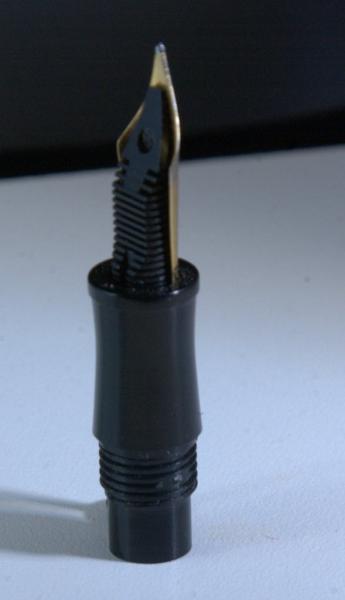

For the sake of clarity, 30.86mm tall without the nib, shoulder to shoulder, outside thread diameter 9.75mm

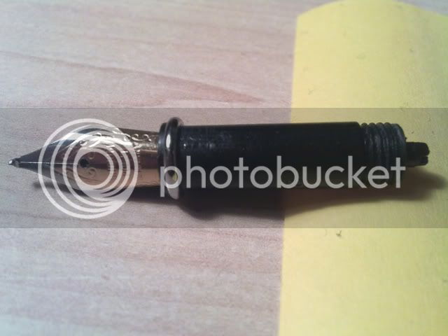

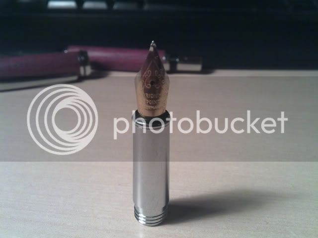

Hi Mike
Good job you posted a picture - it's a bit different from mine:
Nib and holder
Nib removed from holder
Perhaps yours is a more up-market Baron - this one is from a kit costing about £9.

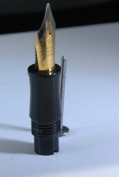

If the feed didn't break all you need is just the Nib . They are very easily replaced without replacing the entire feed unit . The nib and feed just pull out of the holder . Replacement nibs are available from a number of different places including Craft Supplies .
Look in the library here , Lou has an article about how to change the Nib . It's not hard and as long as you line everything up it all just slips back together .
